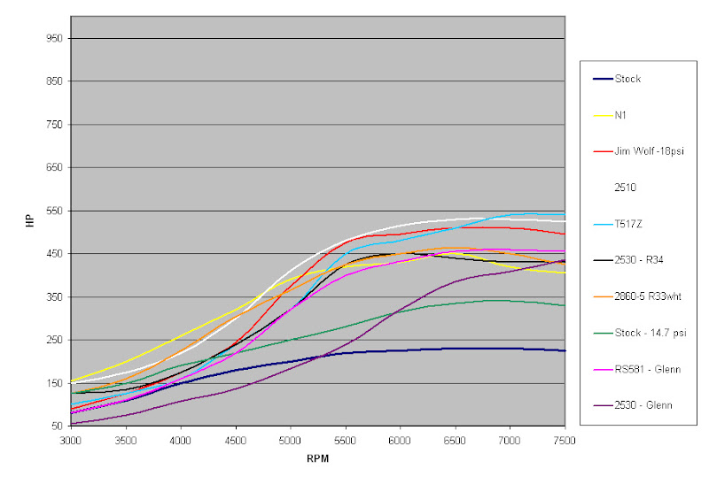

Quote from a previous thread
Turbo lag - turbo response - real or imagined - FreshAlloy.com Forums
Pay attention to the Blue line - that's stock. Black line - a pair of 2530's on an R34. At no point do they make less power than stock turbos from 3000rpm on (below boost threshold).
Look at the orange line. A pair of 2860-5 turbos, the famed '2530 equivalents'. Also at no point from 3000rpm on do these ever make less power than stock, or even stock with the boost cranked up to 1 bar.

Depends on the mods done etc probably. I still swear GT2530s feel laggier than stock when you actually drive an equivalent car running them.

wasn't there a debate over 2530s being more powerful than 2860-5s? guess that chart puts that debate to bed - 2860-5s rule
I buy the chart - there are other factors of course, but IIRC Tyndago put that chart together to give some kind of meaningful comparison.
You mean apart from the fact that 2510s made more power at every rpm apart from a small section where they are very similar??
hmm, odd plus, 450whp is a bit low for both 2530s and 2860-5s.

Nice chart ! Now you now have the Imperical data right in front of you, select the turbo's that you think best suit you and the direction for your cars future, I love the graphs. Thanks.
