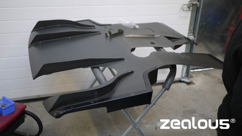

work is progressing
Including.... but not a complete list!!
Front & rear diffuser:- clean, mask, etch prime, satin & clear coat metal areas. Fit new green Zn fixings + copper grease.
Clean front lower undertray/splitter.
Media blast shocks/springs ready for paint.
Clean metal ends of carbon prop shaft, mask off, etch prime & 2K satin paint.
Clean all plastics - front under tray, arch liners, tank & attessa guards, loom shielding, brake ducts, air diversion ducts etc.
Clean & polish ally shock platforms.
Mask prep, etch prime & paint shock bodies.
Clean ally wheel spacers. Clean, prep, mask & paint rear tow hook, rear inner arch brake shields, Nismo suspension arms.
Strip down & clean, new grease and fit new boots & boot bands to drive shafts.
