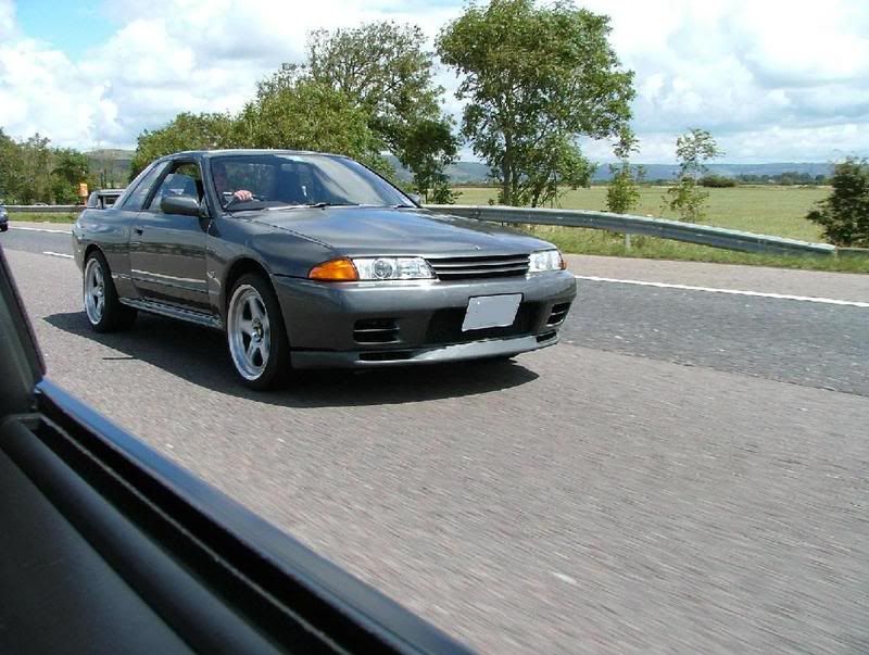

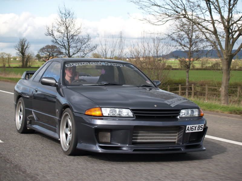

For anyone who hasn't seen it, this is how it started:
And this is how it's been for the last 3 years:
