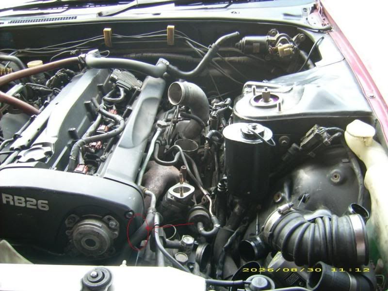

hi this pipe started leaking while i was driving and drained most of the coolant in my radiator, can anyone tell me where it goes to, if i done any damage to my engine and where can i get a replacement part from (pics not from my car btw lol)

Thats the water feed to the tubos...as in to cool the turbos, so yeah its pritty important...
Just replace it with another piece of rubber/silicone hose... & depending on how much water you've lost (hopfully not to much) you may need to bleed the coolant system.
Its simple enough, theres a 10mm bolt at the front end of the air balance pipe above the throtle bodys, open it, bleed out the air &....:thumbsup:
