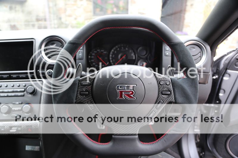

Then the CF smoked dipped bits of trim came back from Andy after just a few days. As soon as i opened the package i was impressed with the quality. I know fake CF is not for everyone but given the choice between that and cheapy scratched silver trim....i think it looks nice.
Sub enclosure giving away no clues about what lies beneath.
The trim comes away really easily in the GTR and so getting the bits off the gear stick as well as the start button surround are nice touches.
This is my favourite bit. Really makes things look different in there.

Great pics, ive just sent some bits for dipping, how difficult is it to remove the silver bit in the steering wheel?

You'll love how they come back. So you need to remove the steering wheel first ; http://www.acuteperformance.com/gtr...Steering_Wheel_Replacement_Nissan_GTR_R35.pdf
The control panel unscrews from behind. Once that's off there's a few more screws and then you pop the PCB away and you're left with the surround ready for dipping.
Keep in mind though you have to disconnect the airbag so disconnect the battery for at least 10 mins before you do that. I still managed to trip some codes but can be reset with an ECUtek cable.
I took loads of photos and kept all the screws etc in little baggies, makes it easier when putting it all back together. I'm no mechanic, there's nothing overly complicated here if you can handle a screwdriver and socket set.
