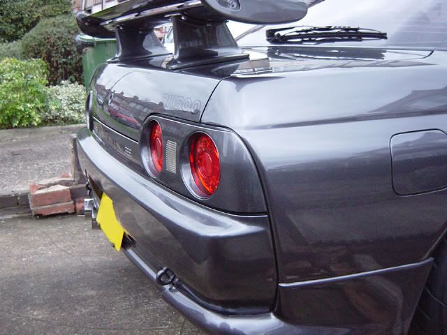

Rear:

Then onto the polishing…… Started with Poorboys SSR 2.5 on a Lake Country Orange Light Cutting Pad, using the Porter Cable (PC) at speed 5. This was the bulk of the polishing work and one pass round the whole car took a good 2 hours. This was then followed by a quick pass to enhance gloss and shine using Poorboys SSR 2 on a Meguiars Yellow Polishing Pad. One pass round the car took about 30 mins.
After polishing:
Once the polishing was complete, I applied a quick layer of Serious Performance Paint Cleanser with a Meguiars Finishing Pad, removed and then followed up with Serious Performance Polymer Super Sealant to the whole car, again, using a Meguiars Finishing Pad and the PC.

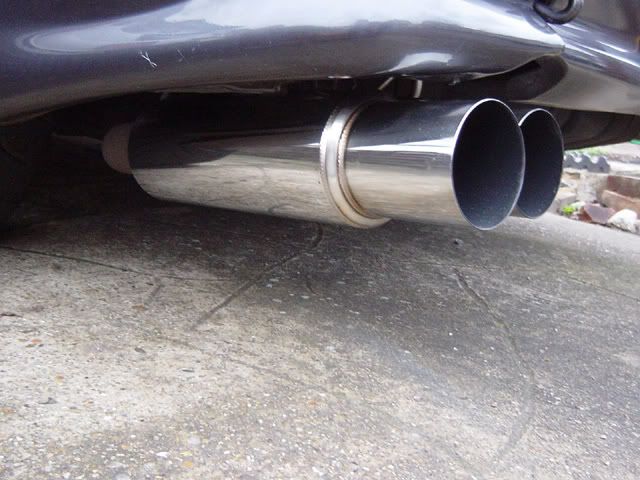

This also gave me time to give the exhaust a much needed clean….
