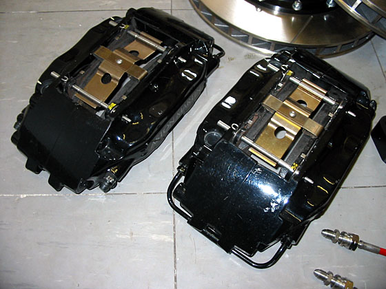

Front brake kit includes everything to bolt onto a S14/a + Skyline
Aston Martin Vanquish Brembo F50 calipers, these are brand new and never been used. They come with a pair of nearly new Pagid RS4 pads.
Rotors are 330mm, Bells and caliper adapters made so that they would fit under 17" wheels.
Pair of stainless braided Hel hoses.
£900 + postage, although pickup would be preferable due to the weight.
Located in Owestry

966 Posts
Kit had trouble fitting unfortunately :/
Brackets were off, having the matter looked at by 3G hopefully. Positive progress.
Thanks to Evilchap for sorting the trade.
966 Posts
Yeah I bought them a couple of months back.
EDIT:
Why they don't fit = Solved.
-The Hub caliper mounting bolt holes are 16mm thick on an S14, when on an R32 GTR they are 23mm, a difference of 7mm. Hence the bracket is pulled away from the caliper and can not be mounted.
Word of thought if you consider a "s14" kit for your R32. I believe R33 is the same.
