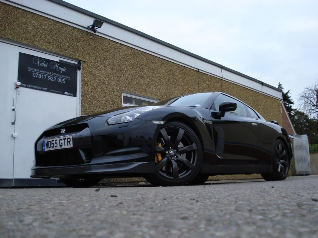

I was contacted a couple of weeks ago by the owner of this amazing car to get some protection on it through winter.
The car was bought down to me for a viewing and on arrival it was noted that the car had slight swirls and holograms in the paintwork from the dealer.
The car was then booked in for a protection detail plus one pass of the machine to knock out the defects and add some real gloss :thumb:
I have to say that i have officially fallen in love with everything about these cars and proud to say that I have detailed one. :thumb:
The car on arrival:
A cheeky snow shot:

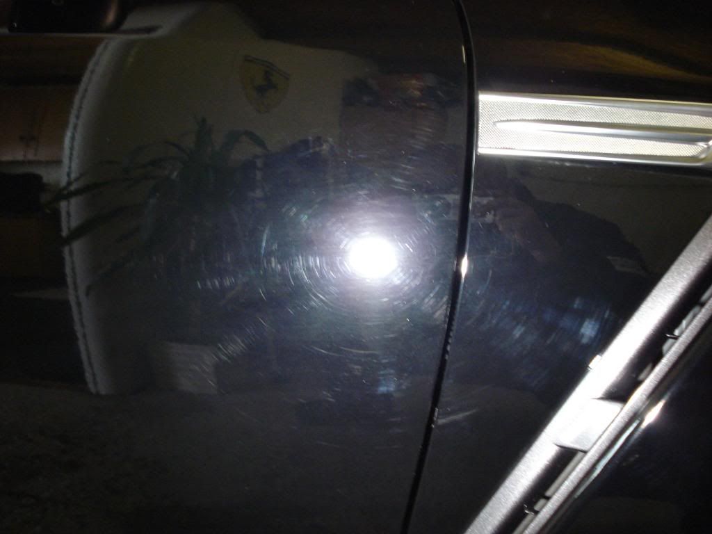

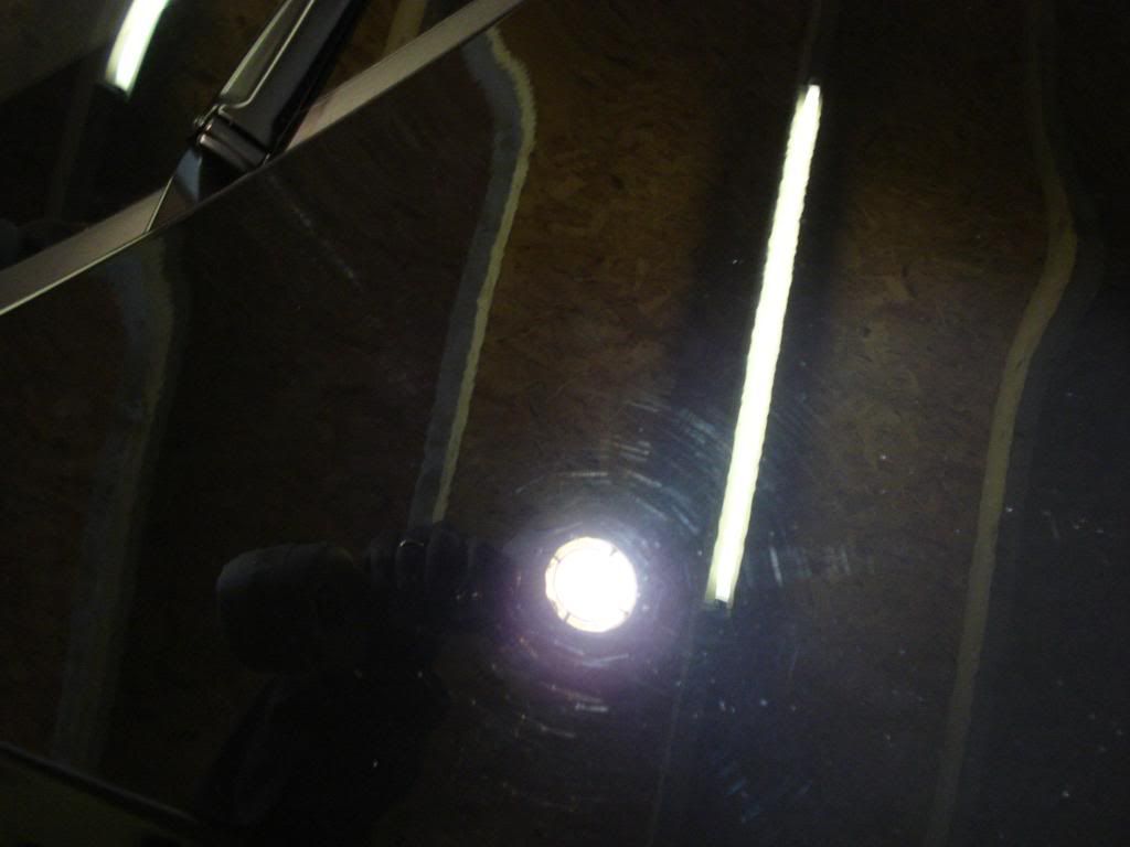

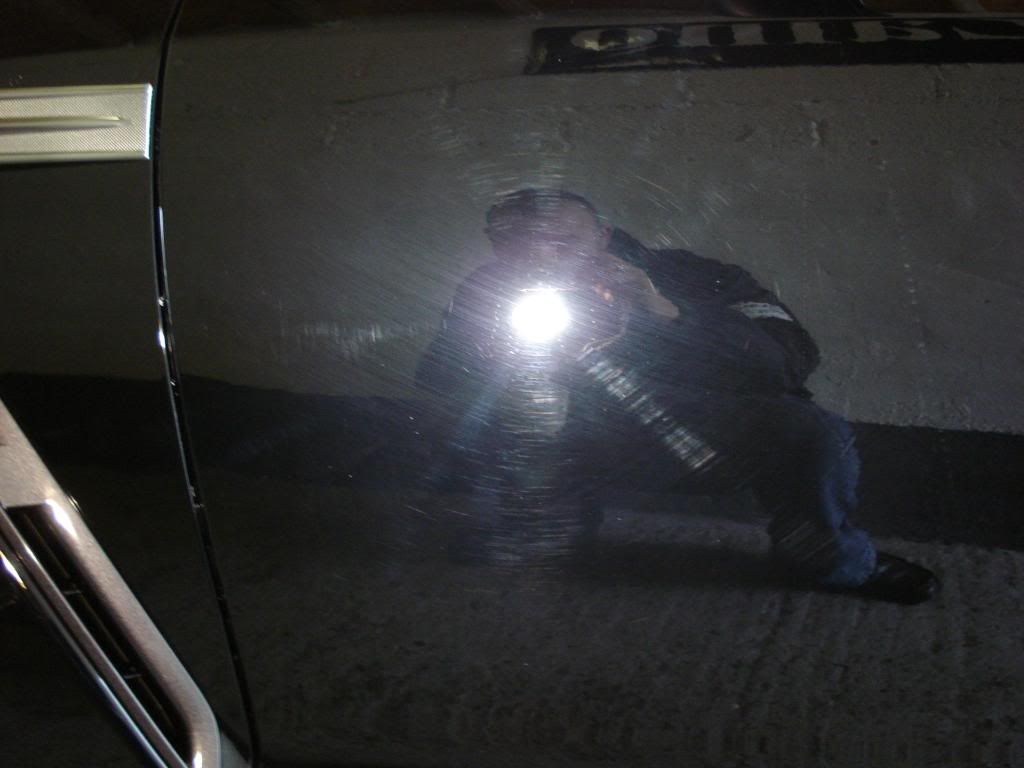

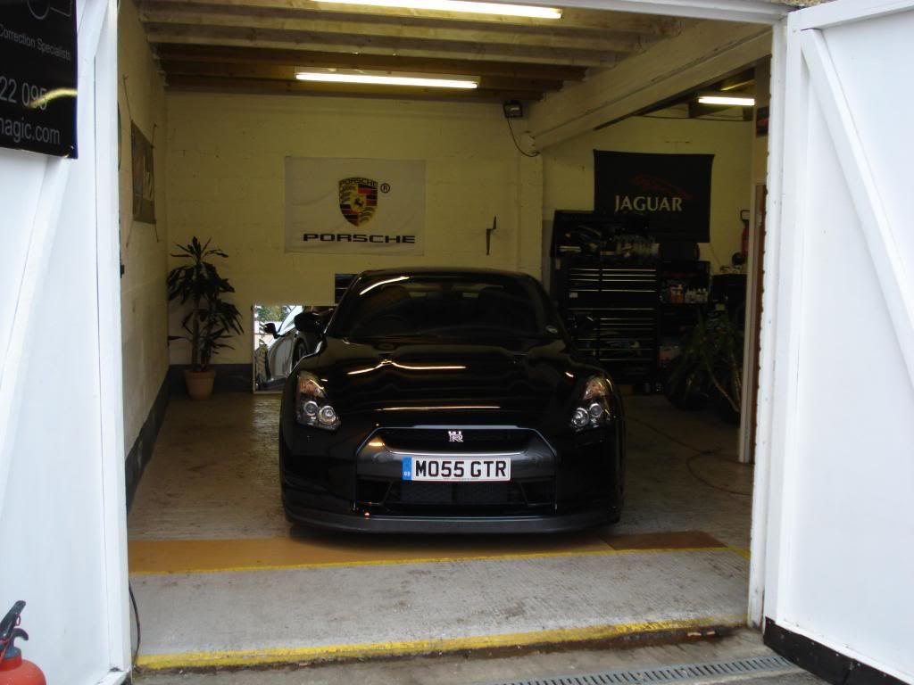

With the car washed, lightly clayed and dried the car was bought into the studio and placed under the lights (static halogens and 3M Sungun)

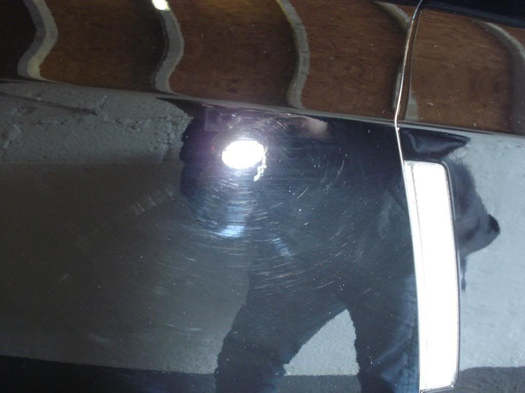

These were some defects found:

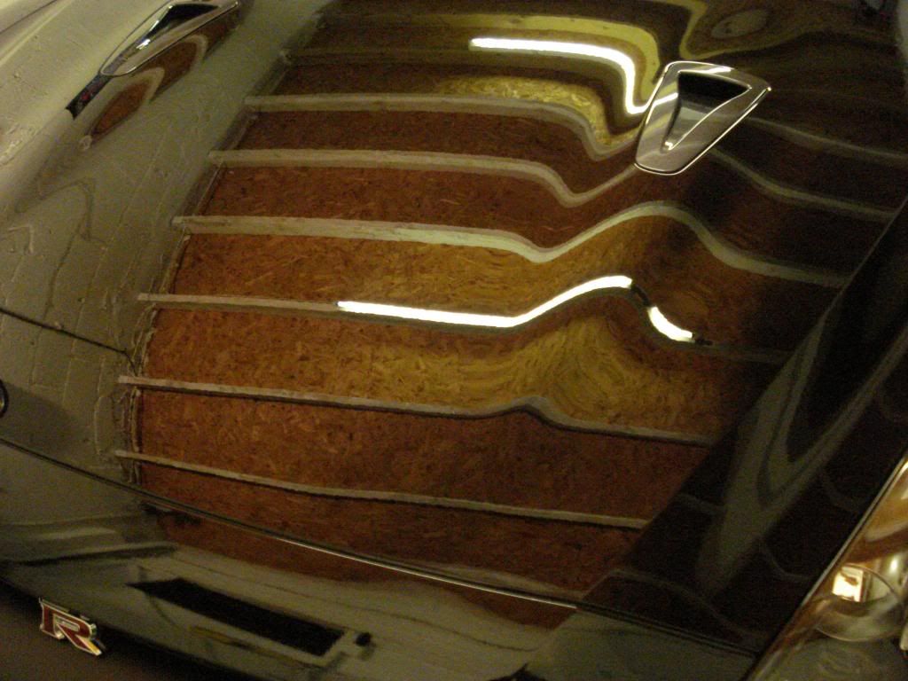

I took some during pics of the process and also this before and after: :doublesho
I had tried a couple of combos but in the end I corrected the whole car with a 3M yellow pad and the new Menz Final Finish (85RE)

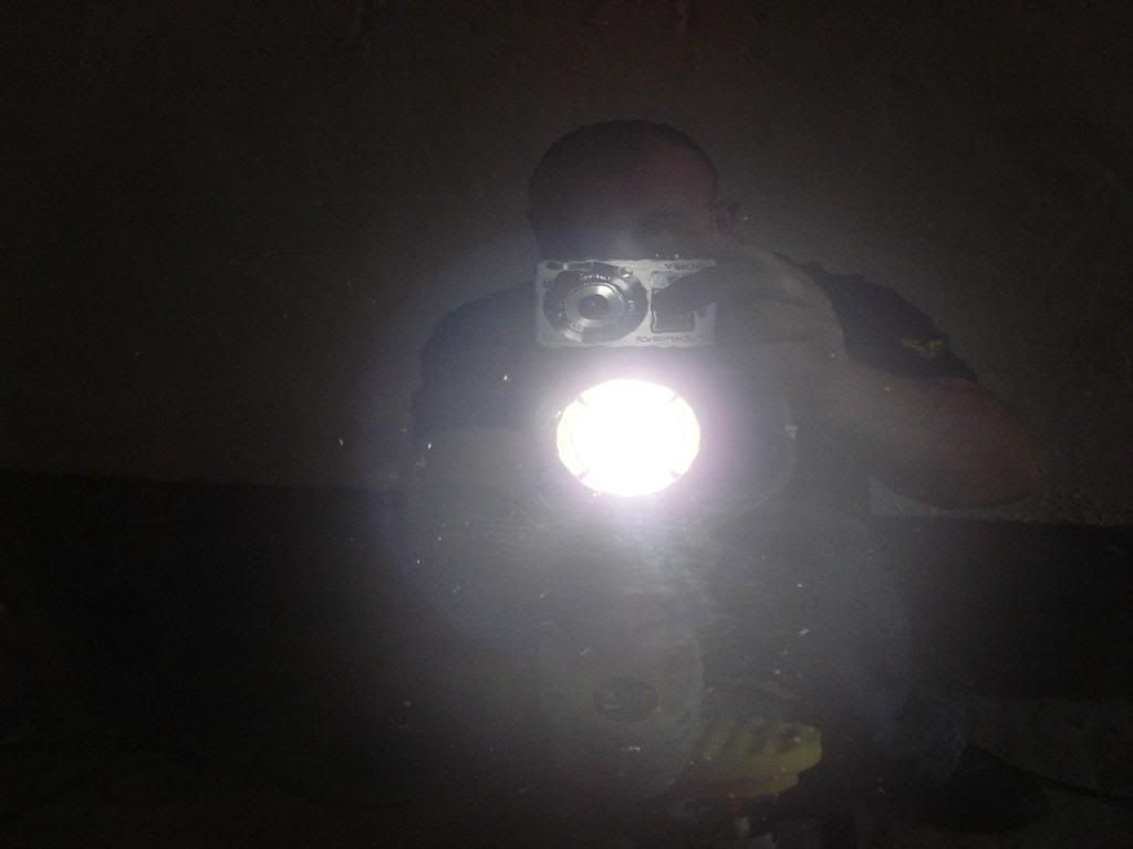

A few during pics:

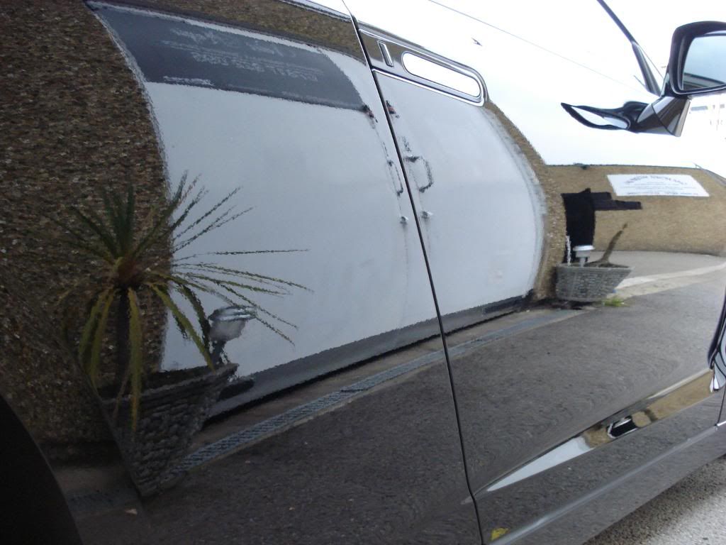

After the correction was complete an IPA wipe down was done and after this I proceeded to Protect the car with the Zaino sealant system :thumb:

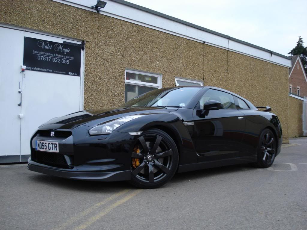

And after 14 hours of love the car looked like this:
