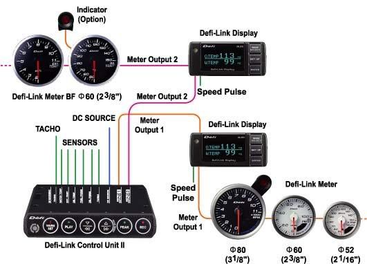

I am going to be installing a full Defi BF meter set in the car, but i was just wondering, ::: the controller unit II, says it can use up to 7 guages, which is perfect, as i want 1) Boost, 2) EGT, 3) Fuel Pressure, 4) Oil Pressure, 5) Oil Temp, 6)Water Temp, 7) Intake Manifold...
But, when i look at back of controller unit II (See below), it only says 6 sensors loaction...
Can this run the 7 guages or when say up to 7 guages, they mean tacho included, (which i wont be using)

Yes thats seven including the tacho.
The turbo boost/intake manifold pressure is one input for either gauge - you wouldnt normally want to run both ? the boost gauge will show vacuum too ! why do you want both ?

The defi link unit will power ONE 80mm tacho and SIX 60mm gauges :
Water temp
Oil temp
Oil pressure
Exhaust temp
Fuel pressure
and EITHER turbo boost OR Inlet manifold pressure (same sensor)
It will then also power a Defi Link display plus a VSD concept OR a VSD II.
Defi link display and VSD concept do NOT display boost pressure or vacuum.
Is that clearer !?

yip, thanks
627 Posts
Kochi
Didn't mean to put a spanner in the works but I was told originally it would display. Your explanation is perfick! :bowdown1:
