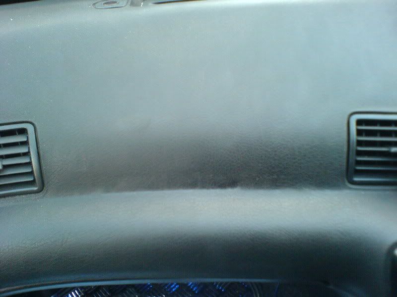

my 32 had a large bubble on the dash which i see is fairly common, being a tight wad i decided to have a bash at sorting it.
all i did was heat the bubble gently with a heat gun (used for paint stripping) then pushed it in and down with a scrap piece of wood.
heres the result. well chuffed! if it does bubble up again all im going to do is heat it again then inject some super glue behind and clamp over night but im confident enough this has sorted it.

unfortunatly not, wasnt really expecting it to work as it was really hard before i warmed it, but then it went really easy.
just looking at the pic above on my screen, from the left airvent about a pen lid to the right was where the bubble started and from the right airvent about 1 3/4 pen lid to the left was where it finished (all i have to hand is a pen lol) if you look closely you can see small indents where the raggy edge of the wood pressed in a little too much although this will prob be sorted by just heating again slightly and using a 'proper' piece of wood instead of some for the chiminea!
