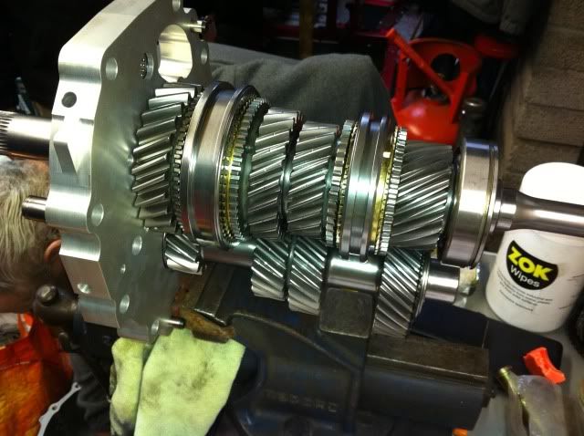

I built mine up with OS 1-4, billet centreplate, new bearings and synchros and had the gears REM finished.
4th gear is the input shaft effectively. Select 4th and the input shaft is locked to the main shaft and drives straight through at 1.00 ratio - most efficient gear in the box, lay shaft is bypassed.
OS 5th is lower ratio and good for top end acceleration but limits top speed to 180mph-ish. Stock 5th will run to over 200mph with a high rpm motor.
Stock 5th also better for motorway cruising.
You shouldn't need much else if yours is a late model 33 gearbox - early one may need some synchro parts and possibly reverse gear components. I built mine from a 32 box which needed a ton of parts from Nissan. I was lucky enough to pick up my new gearset and most of the synchros from Yahoo Auctions Japan for a bargain price.
I would definitely put new synchros and shift pawls whilst it's apart.

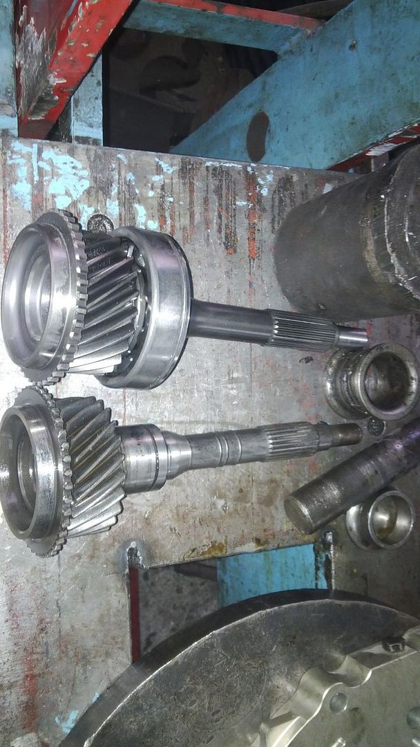

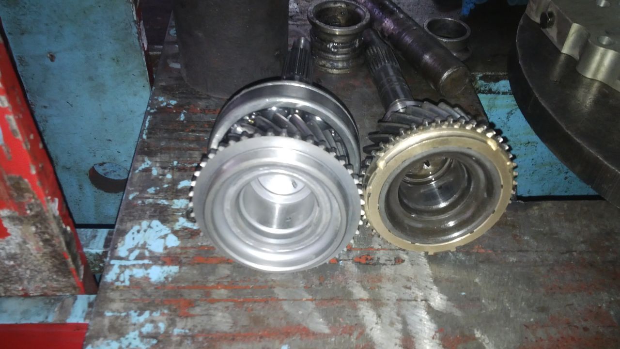

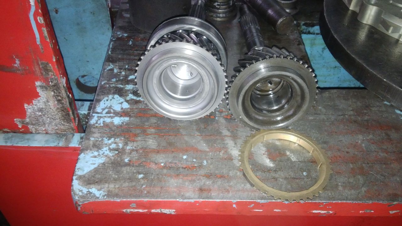

Hello everybody,
I started working on the 1-5 OS kit. I have a problem currently, I would appreciate if someone could help. My mechanic is saying that there is a difference between the synchro sizes, see pics below. Anybody knows where can have these? I bought all stock synchros from rhdjapan, this one though I don't know where to get from. I'm assuming this is a GTR33 box I hope I'm not wrong, we installed everything except this synchro I'm asking about. The new shaft is on the left without a synchro, the stock shaft is on the right with the synchro. The stock synchro doesn't fit the new shaft.
3,849 Posts
Maybe your old box was Auto Gallery Yokohama modified?
They machine the gears and use multi part synchros for a better shift.

Great. I have been thinking to increase my turbine housing size (currently 0.84) since as you mentioned that the long ratios help spooling and having big turbos. What's your turbo set up and what power you have please? On my PTE6466 0.84 I guess it would be fun to drive though.
For my issue above, my bad I missed getting the 4th gear synchro (32604-40P61).
