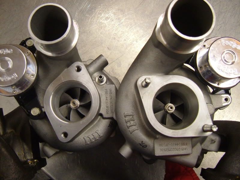

Sneek peek of UK GT-R Turbo's CNC machined in UK for 700hp +

ok more pics and info on turbo kit...
sneek peek Pics of modified Euro spec GT-R turbo's that will soon become part of a GTC power package
For those who didn't know there appears to be some differences from US/JDM/EURO Turbo's one being casting, also Euro spec turbo inlet pipe doesn't fit the US turbo (hits the block)
We won't be offering this turbo upgrade until Thistle's new developments (air/fuel/ign caluations, injector scaling etc...) have been implented into the accesstuner pro software and hopfully Joe's work on TCM will have neared completion.
Here are the pics of modified UK spec R35 GT-R Turbo's. Not from our 35 demo car yet (as its currently being used for cooling r&d) but GTC dealer Kevan SVM.
Machined in the UK, OEM turbine and compressor housings GT-R ball bearings turbocharger upgrade
*BALL BEARING IHI CENTRE CORES WITH MACHINED OEM HOUSING (FACTORY LIKE FITMENT, USING ALL STOCK FEEDS /WATER AND OIL LINES. BOLTS UP TO STOCK PIPING AND INTAKE FOR EASY INSTALL)
*LARGER COMPRESSORS
Wheel sizes.....Original Comp in 43.4mm ex 56mm Turb in 53mm ex 40mm
Hybrid Comp in 46.5mm ex 60mm Turb in 53mm ex 47.8mm
So you can see the hybrid comp is 4mm bigger and turbine is 7mm bigger. (Also notice some US quote comp wheel std 42mm, USDM/JDM possibly smaller)
*LARGER TURBINES , EXHAUST WHEELS TO REDUCE BACK PRESSURE..
The ultimate power upgrade for any GT-R, these brand new turbos feature fully dynamic precision ball-bearing core assemblies to dramatically reduce spool-up time and give maximum airflow.
The fully machined and flow ported turbine housing and manifold assembly reduces exhaust back pressure and maximise gas flow, whilst retaining the original mounting points making the turbo a direct swap for the standard unit.
The modified compressor housing is mated with a larger, high-flow compressor wheel which is specifically developed to give maximum bhp and torque with minimum lag.
The uprated actuators feature an increased spring preload and durable, heavy duty mounting brackets.
We believe these units will support 750bhp + (depending on boost and fuel RON) with very little lag. Full dyno and drag testing will follow in new year....

Ben are you trying to get me divorced? I prommised the wife that I wouldn't tune my R35!
One question, does the engine have to come out to change the turbo's?
PS - Perhaps she wouldn't notice the new turbo's

Hi,
yes indeed engine out. Used in combo with 800-950cc injectors, cooling modifications, set up calibration. VR limit is close to 600hp, so forged internals, head gasket etc.. recommended. we'll be finding this all out on our own car first of course.
Funnily enough these modified oem turbo's are very stealth, appears just like normal burried deep down, so your missus and maybe even HPC wouldn't notice ;)
Manifolds being coated tomorrow and back in engine over weekend
CNC machined turbo's for 700+ won't cost more than 2,900
