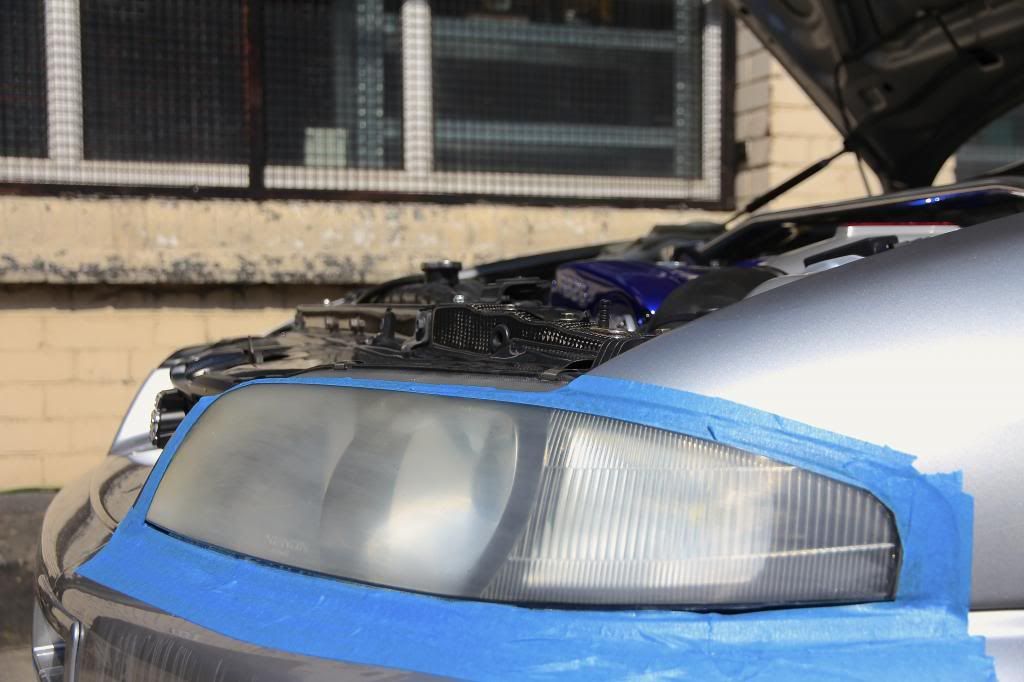

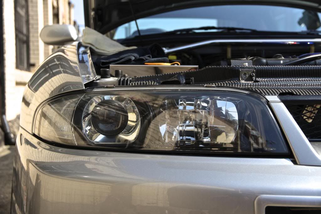

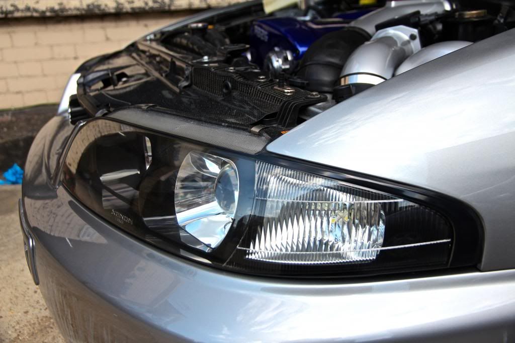

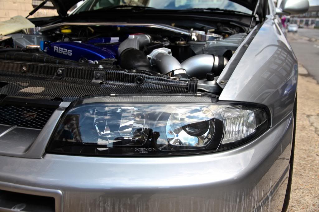

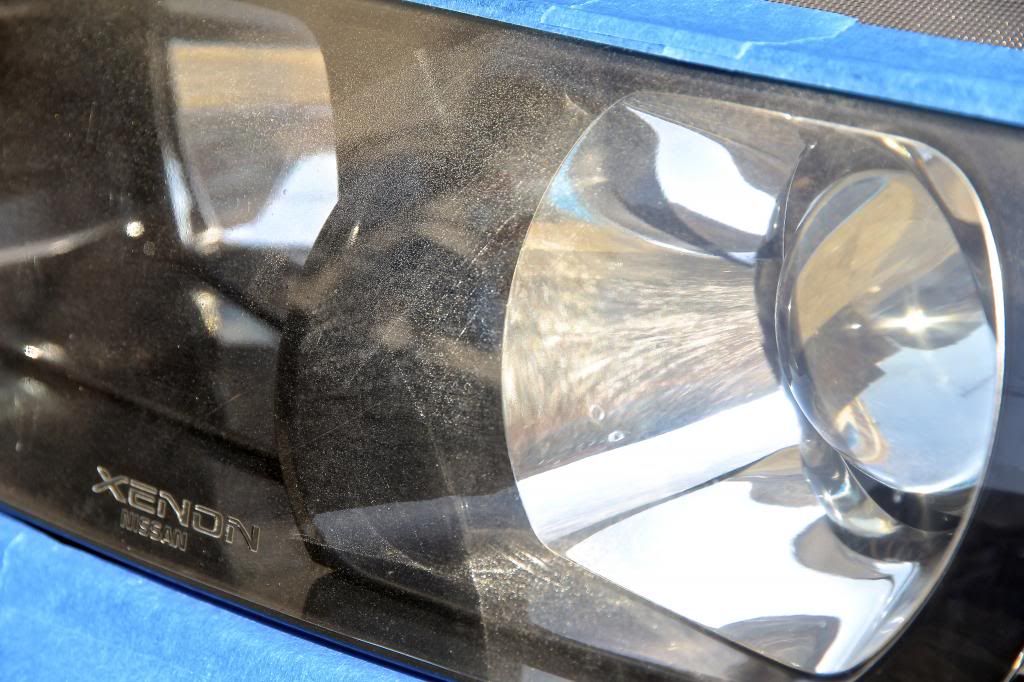

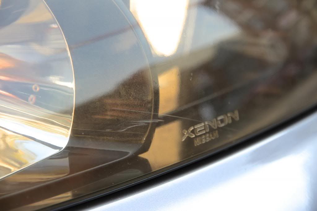

Had some time on my hands over the weekend
so gave the GTR headlights a wet sand and polish as they
were scratched all over.
Made a video as well so you guys can see how its done :thumbsup:
R33 GTR HEADLIGHT RESTORATION RESTORED BUY MOTORSHINE - YouTube
SCRATCHES ALL OVER LENS
AFTER 2000 GRIT SANDPAPER
AFTER 3000 GRIT SANDPAPER
THEN MACHINE POLISH OFF THE SANDPAPER MARKS
AND YOUR LEFT WITH THIS
