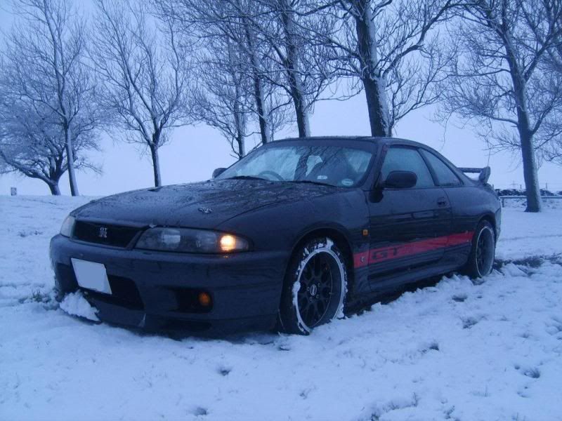

I have 18 inch Ultralite nurenbergs with 343 mm AP racing discs on my Stagea
There is enough space for a bit larger but I dont think its enough for 356s . The offset will have to be spot on as well.
and yes I took the 2nd pic before I put all the wheel nuts on.
