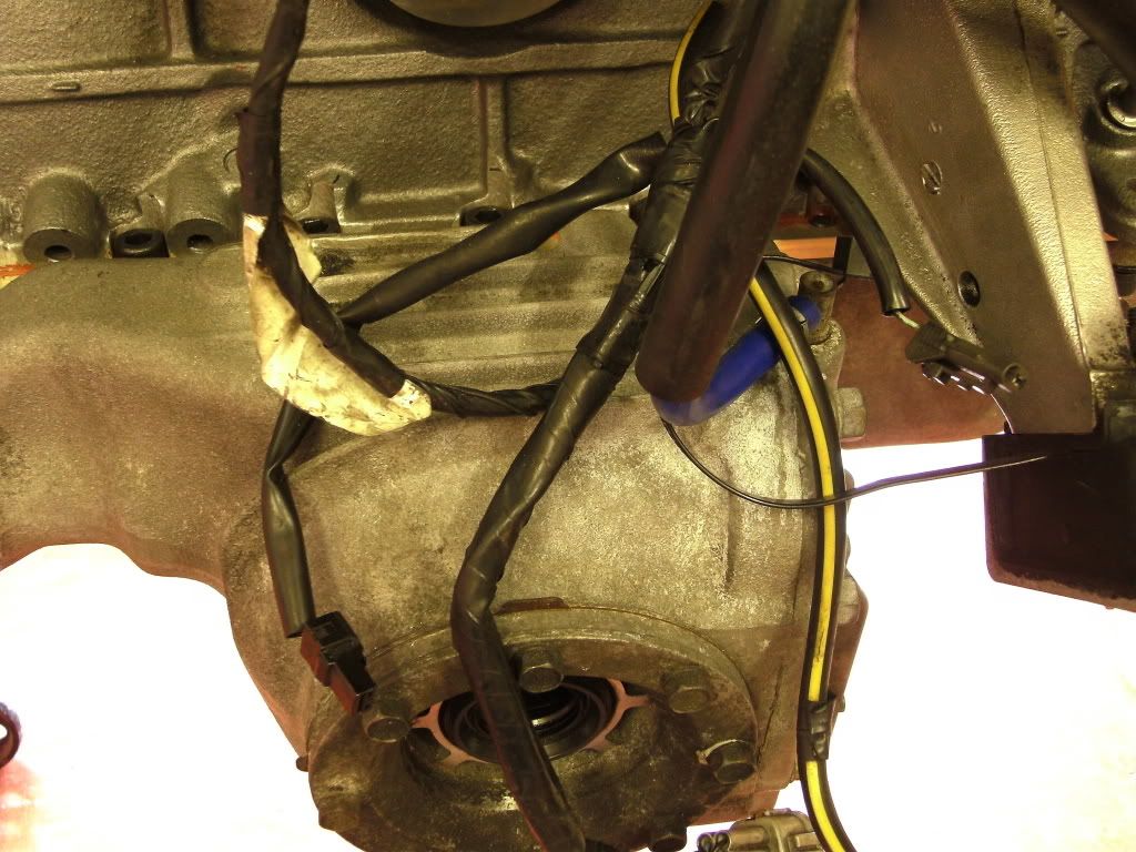

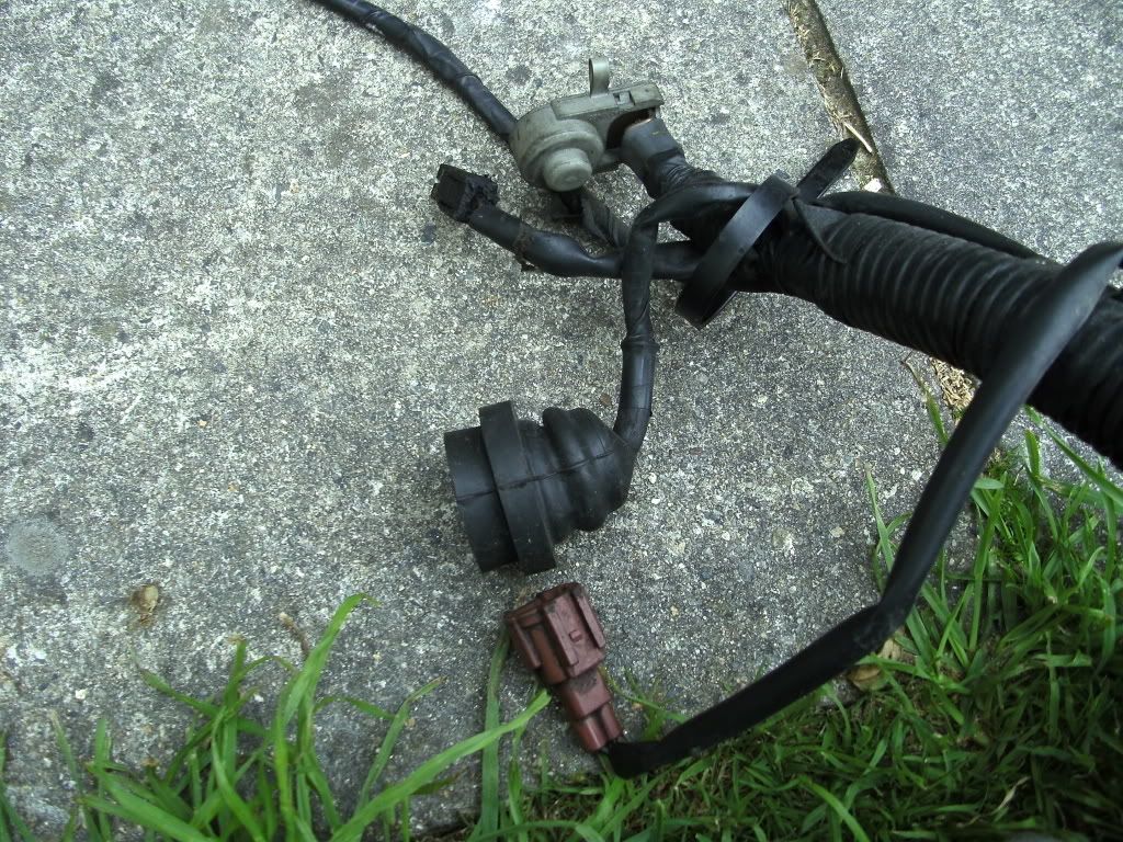

Hi there guy's need a little help remember where a couple of plugs go!
Is the small black plug in this loom (alternator Loom) for the water temp sensor on the top hose body?
Is the small black plug on this loom (loom with knock Sensors) to the left for the oil temp sensor?

Arrh yes starter motor. That explains why it's right next to the grey capped connection! So what wire goes to the water temp sensor on the top hose body?? I am sure I will work that out. I will put the injector loom on this weekend if not before so I'll see what I am left with then.
