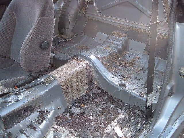

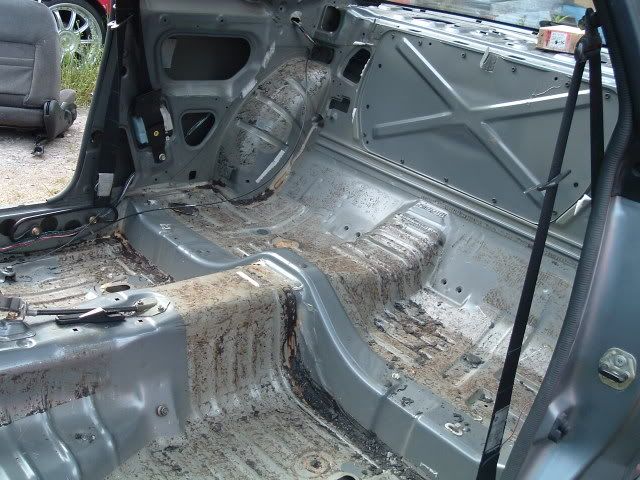

As it was off the road doing nothing, I thought I'd rip the interior out as it was a free mod, (and the interior wasn't in great condition anyway!):

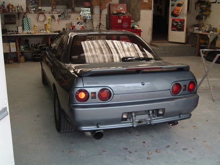

And while I was welding/filling/painting, I got rid of the boot spoiler:
Neither job is done very well, but I'll tidy it up when I paint it properly.
