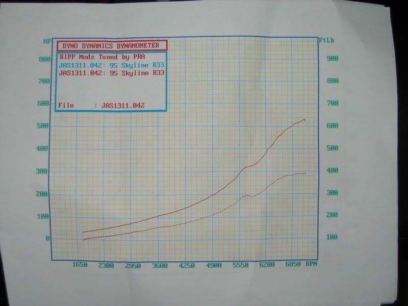

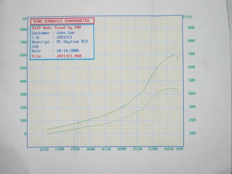

Thanks to the guys @ Ripp Mods, Ross, Perry and Phil for the time, help and use of their dyno.
After some tuning with my tuner and Perry and starting out from 330 whp @ 10 psi
We settle her in @ 530 @ 16 psi
We maxed out the 750cc injectors @ 19psi and made 599 whp.
Here's the mods again so there is no need to back search:
Stock Bottom and top- R34 N1 motor
HKS 264 cams
HKS 2530's
Greddy intake manifold
Greddy Spec R HG 5 Row I/C
RC 750 cc injectors
AEM FPR
Greddy rail
AEM EMS
NGK iradium plugs
Attkd o2 housings
nismo down pipes
ARC Ti 100mm exhaust
That's it for the motor now onto a rebuild to get more out

Thanks, we still have to get rid of the flat spots, but one of the turbos let go. So now on to biggeer and better things.

Awesome power!
How comes you dont rev past 7250?

Good question. I told them I wanted to end it at 7500, I think it had to do with running out of fuel though. I'll find out.
Whatcha need on the bottom of the graph :), I'll get you a copy.

Congratulations for the tune, the power curve looks pretty smooth, I also used a HKS 2530 serie in my car. Great spec:)
