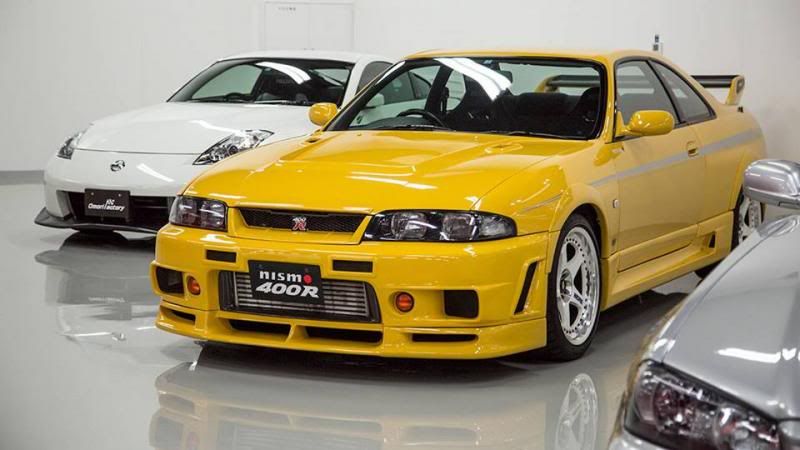

Does anyone know what lurks behind these rear sideskirt vents on a genuine Nismo 400R??:confused:
I'm curious to find out if the bottoms of the Skyline OE rear quarter panels were chopped up or modified in some other way to make these sideskirt vents functional for cooling the cars rear brakes? If so, what was done exactly?? And...was it at all effective?
I'd like to think that these do in some way work and are not just there for cosmetic purposes. I've scanned "ye-olde-interweb" for a while now and have been unable to find the answer.
Please help if ya can folks, Cheers!:bowdown1:

Here is a link to a dealer in Japan who is trying to sell one. He has photos of various parts of the car, including the delicious dry carbon fiber bonnet. Notably, look at the photos from underneath the car, of the rear link and axles. I see no tubing of any kind to suggest that air was being routed back there.
Prostock 400R
Click on the photos to scroll through.
Also, there is one photo that shows the rear duct in question. I think you can see day light.

Thanks for your reply and the link above Aki! That Prostock 400R for sale is simply stunning matey!:)
I also hope you get to see a 400R in the flesh and soon too, So you can put us all out of our misery for good regarding these vented Nismo sideskirts.
