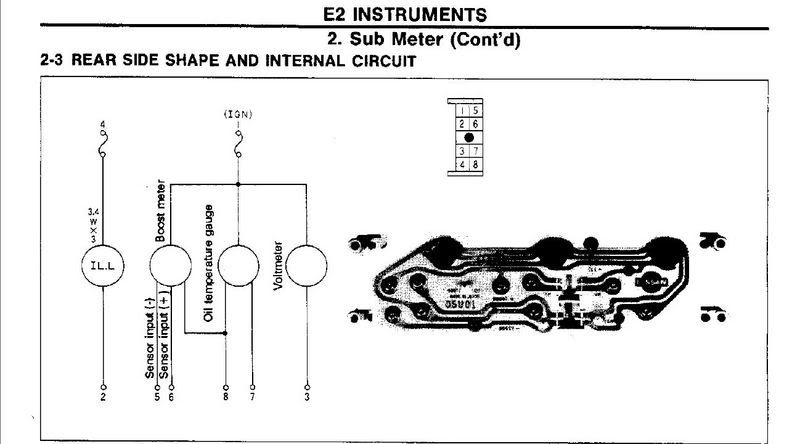

red constant power 12v wire goes to #3
white ilumintaion 12v wire goes to #2
orange ignition 12v goes to #8
black - ground to body
I'm trying t wire in 3 Greddy gauges.
Is this correct?
I have no engine or elecricity so I can't check the wires with a meter.

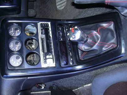

What do you think of the location for the new gauges and the heater control shuffle?52mm gauges barely fit in there:)

That looks very nice mate :bowdown1: . Not an expert but I think your spot on with the wiring IMHO. All wires seem to go to the right services. Make up a test lamp using a bulb+holder (unless you've got a proper one LOL) and try it out. If you have lots of in-line fuses lying about, dummy install them using the in-line fuses and see what happens.
Looks fine though TBH
