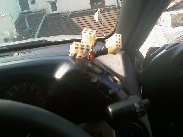

Pull the dash surround towards you (check that you haven't missed any screws) and unplug all of the switches (wipers, lights, rear heated screen etc)
Pop off the button from the headlight switch - Just give it a pull (otherwise you will not be able to get the switch out of the surround)
Once you have the surround free from the dash you will have more room to get a screwdriver in to remove the switch (it is held in by 3 small screws)
I used a small screwdriver to split the switch, you can see the 3 electrical contacts that act like a seesaw when the switch is turned (carefull with the 3 black "cams" on the LHS part of the switch in the image, they may spring out).
Get some wet and dry and give all of the contact areas a good clean up (I also did the pins in the connector). Once you are happy that everything is clean pop the switch back together, plug the switch back in to check the headlights before refitting all of the dash.
Refit the dash surround and admire your working headlights.
