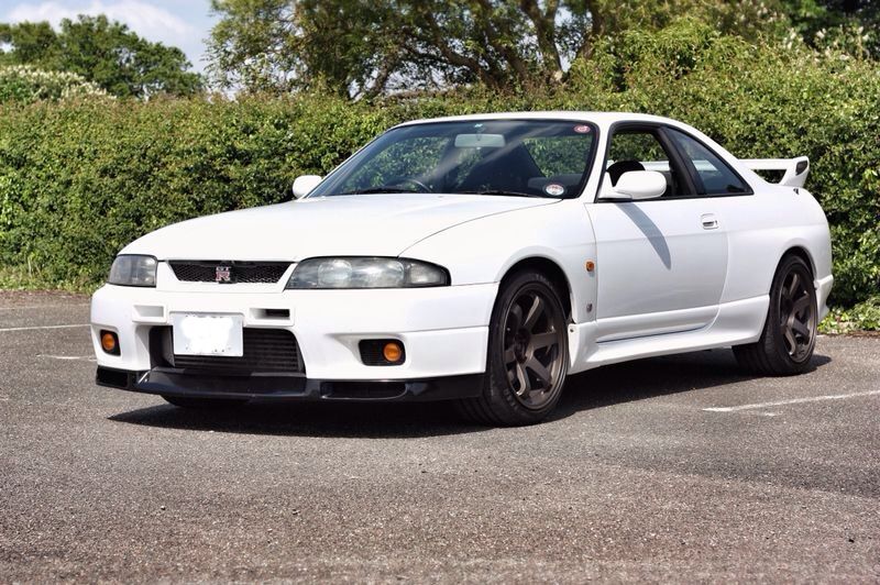

Hello guys. Thought I would have my first go at a project thread so bare with me until I get the swing of things. Owned a r33 gtst few years ago and ever since then I have always wanted a GTR. So a few months ago the time was right and I brought this.
The only things I have done externally are, replaced the fibreglass vented bonnet with an oem alloy bonnet and spent 3 days repairing the cracked and broken splitter and painted it black (it was white)
