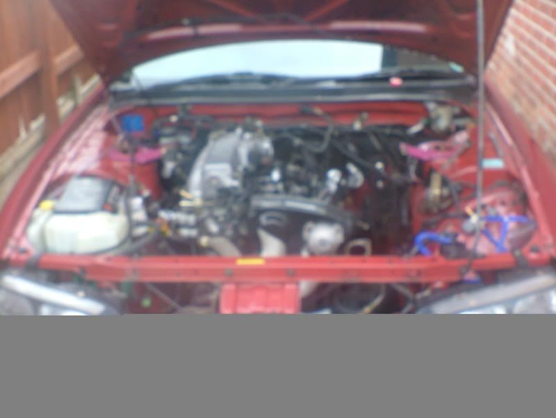

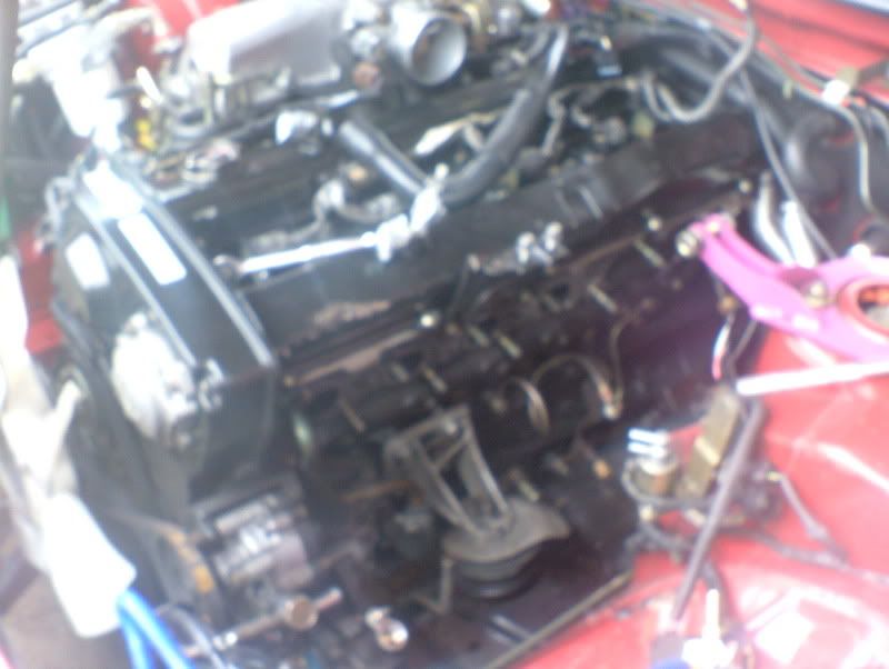

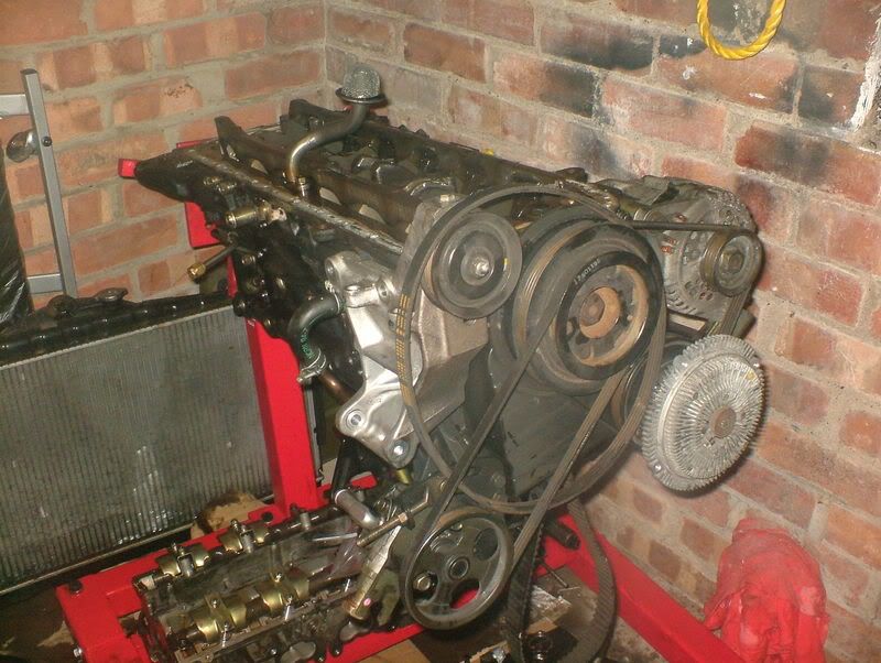

PICS OF ENGINE COMEING OUT ARE ON ANOTHER CAMERA

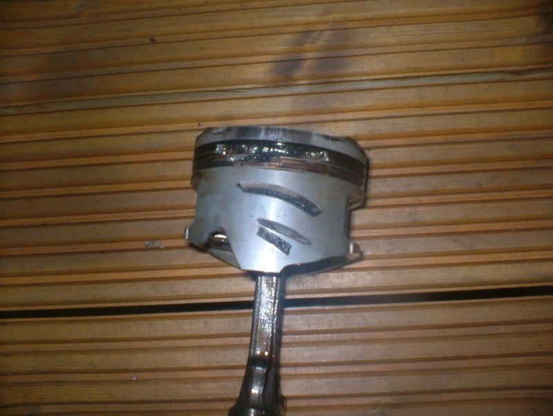

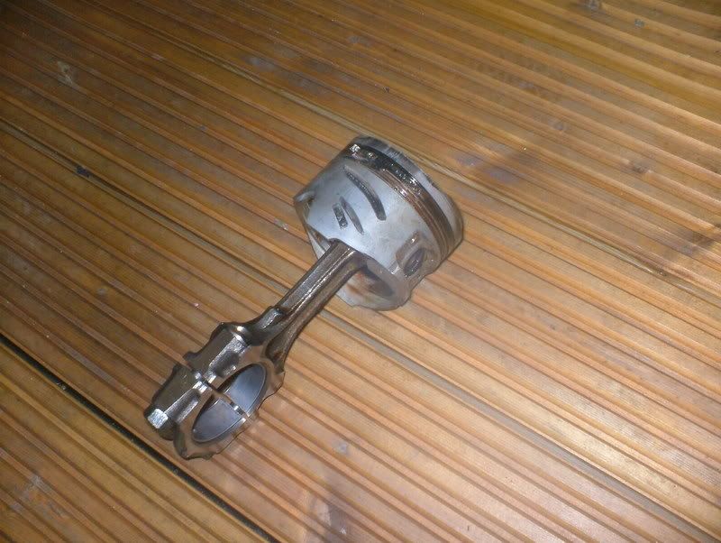

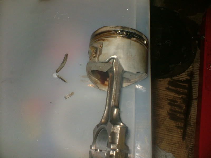

the damage -

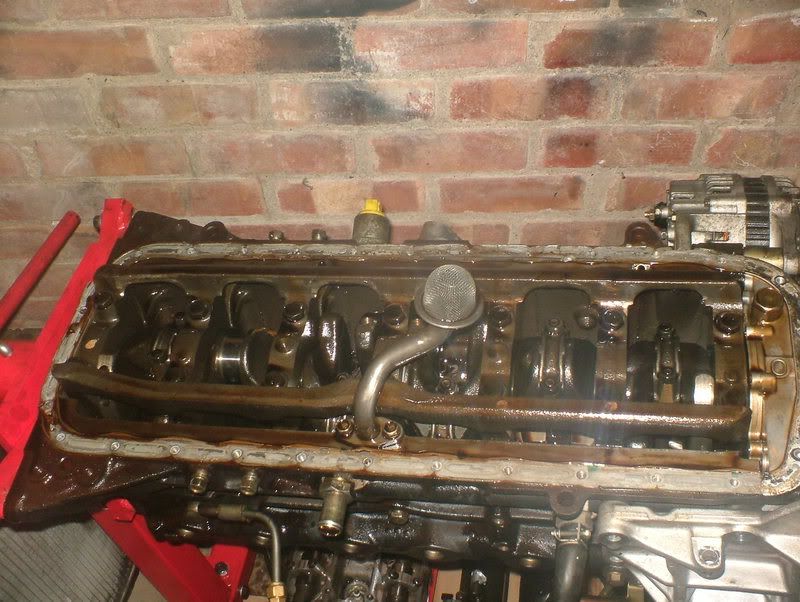

everything else on the engine is spot on all the other pistons the bearings the crank all look brand new, but there you go it only takes a couplr of tiny bits to brake and the hole thing comes apart
i am planning on putting wiseco pistons in and maybe ACL headgasket and bearig,if anybody has any ideas help or advice it would be very much appreciated.

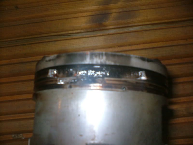

got back of me hols yesterday so thought i would drop the rest of the pistons out, and found this on number two -
there were also another two starting to crack !!!!
6,393 Posts
Ouch.
well at least you know you HAVE to have a rebore now. 87mm pistons and GTR rods a good way to go for you HP goal.
