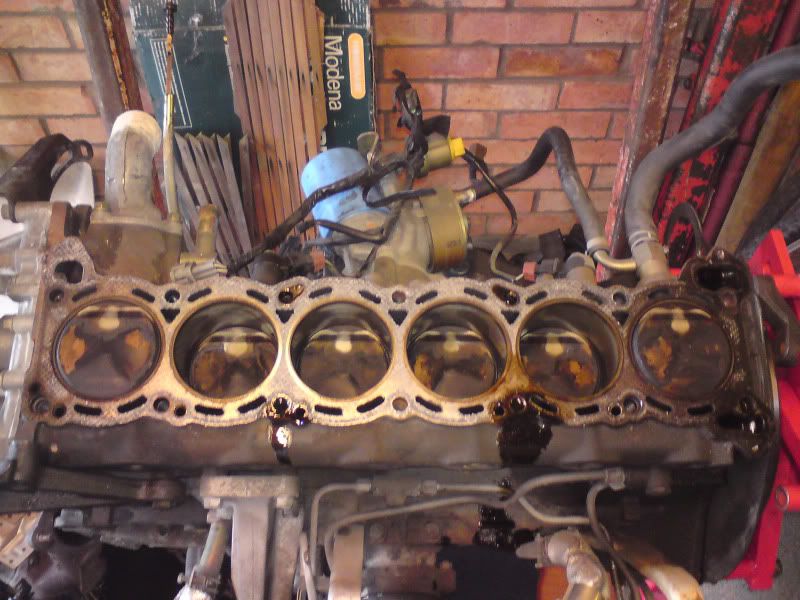

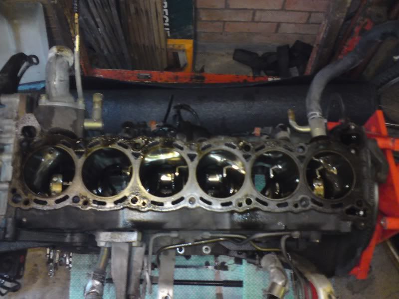

This wasant planned but from a trouble free day looking like this
to the following day like this couldnt see behind me for smoke so.....
Then just a block..
Now to make up a list of needed :?

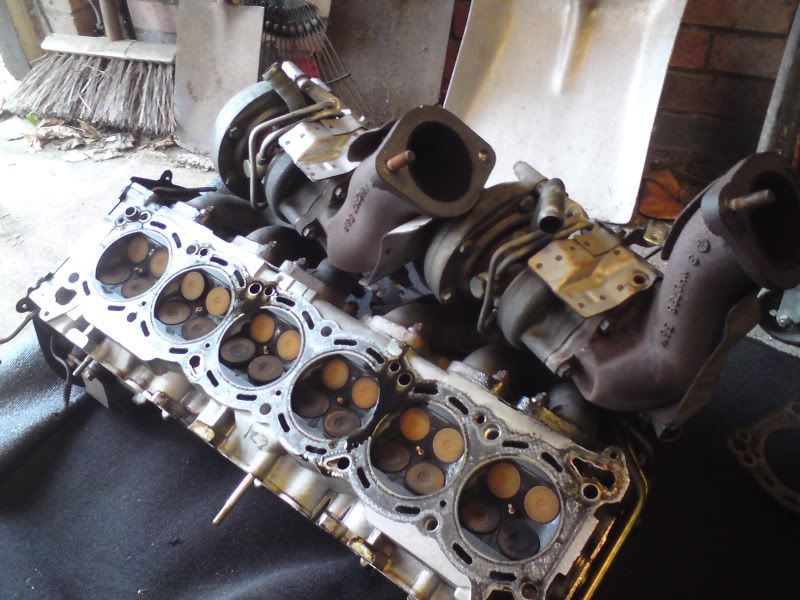

Did you find anything wrong with the engine or had you just blown a turbo?
Nope engine is sound really impressed with the condition of the inside of engine , just rear turbo oil seal gone , but what the hell why its out why not do a proper job , Got a spec list ill put up shortly get your fed back before i hand over my hard earned cash :bowdown1:
