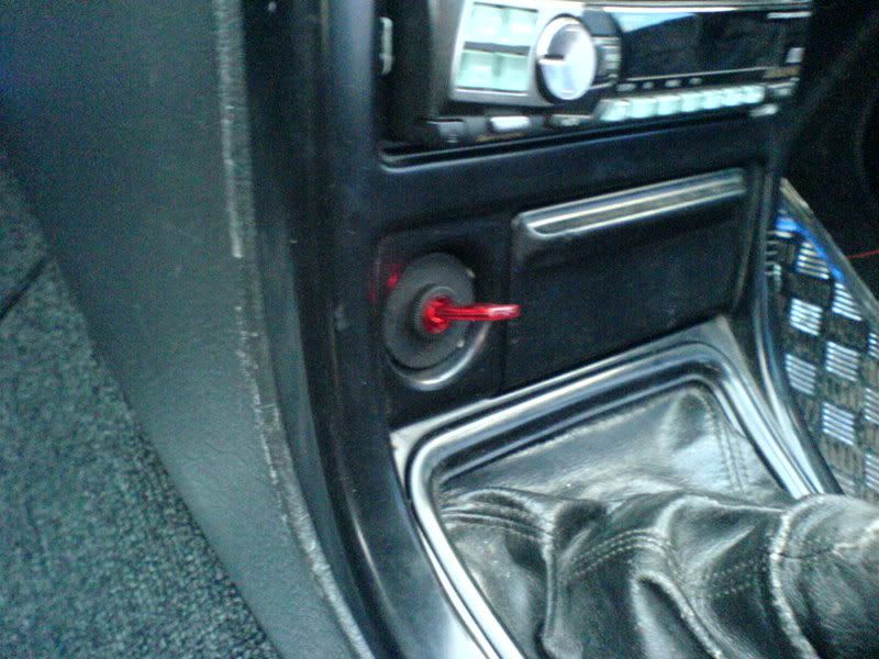

not wanting to hack apart the dash to put in an ugly rocker switch for the fog light i bought a light up toggle switch from halfords, removed the cigar lighter and insulated it, plugged in my road angel and left it tucked away behind the dash, found a washer the same size as the hole bolted my switch to it, painted it and used some double sided sticky trim tape to keep in place, very secure and looks far better than the big rocker switch i had.
the light i just replaced the offside reversing bulb with a red for light bulb and fed the wires through to the switch.

just changed the bulb, was going to mess about with standard fog light switch but it has to have a warning light when lit and would still have to put an led in dash so figured this was easier option.
cant remember off hand which fuse is for the cigar lighter but its under the dash, on mine i wired up another cigar lighter behind the console to plug in my road angel looks really neat not having wires everywhere.
