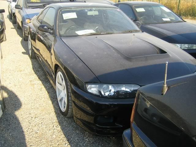

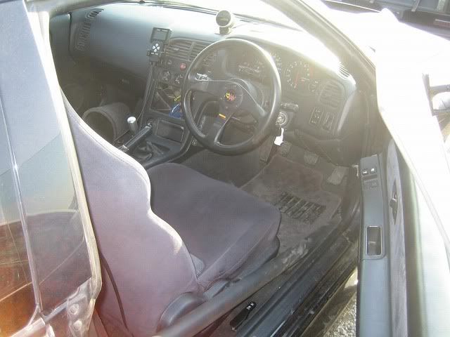

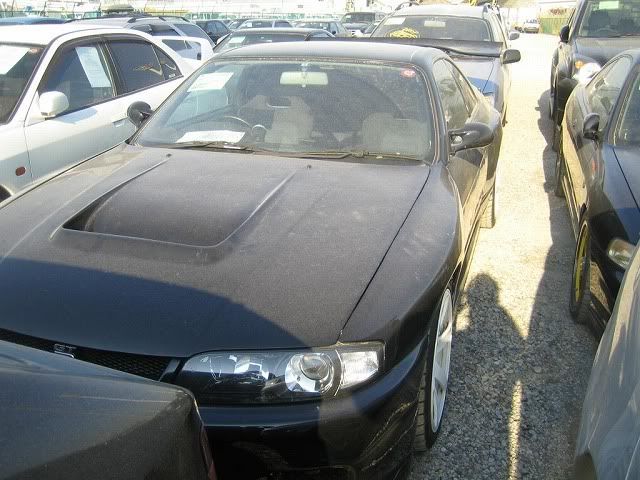

auction pics from when i bought it

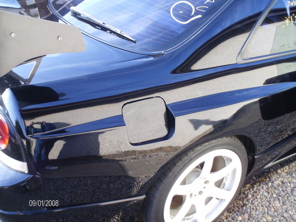

whilst sitting at the docks in japan i got these sent

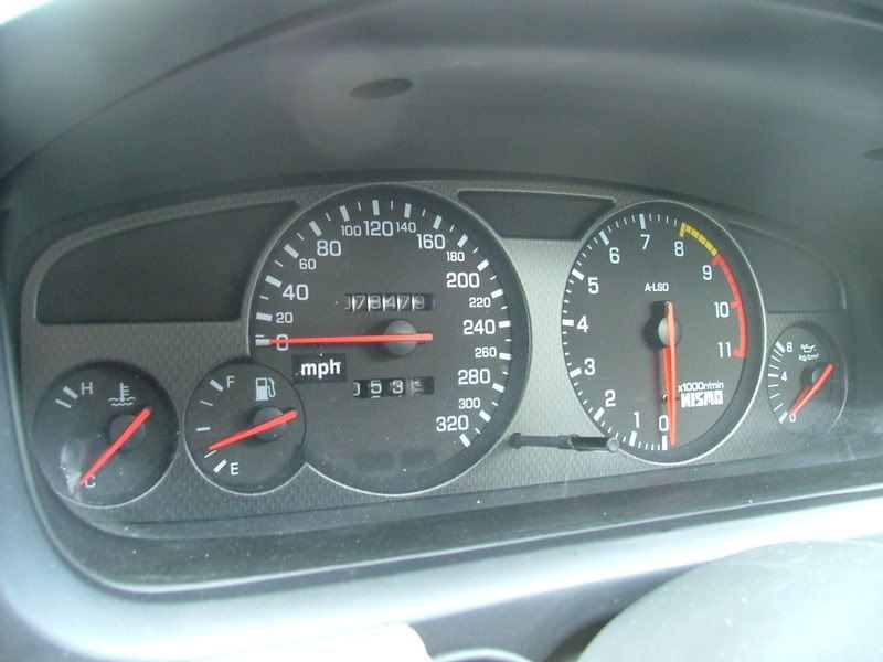

nismo dials and gauges

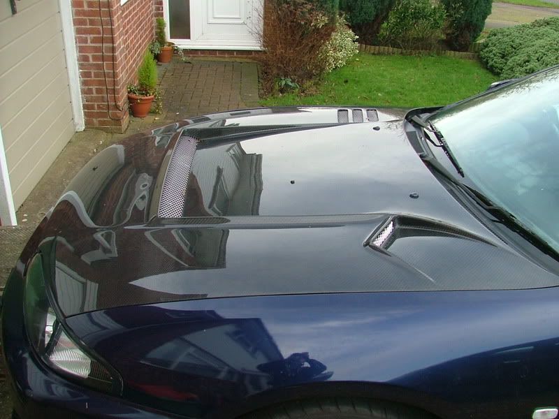

top secret c/f bonnet
