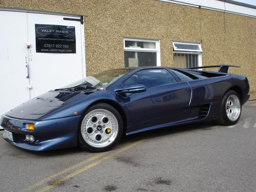

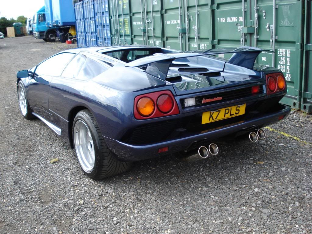

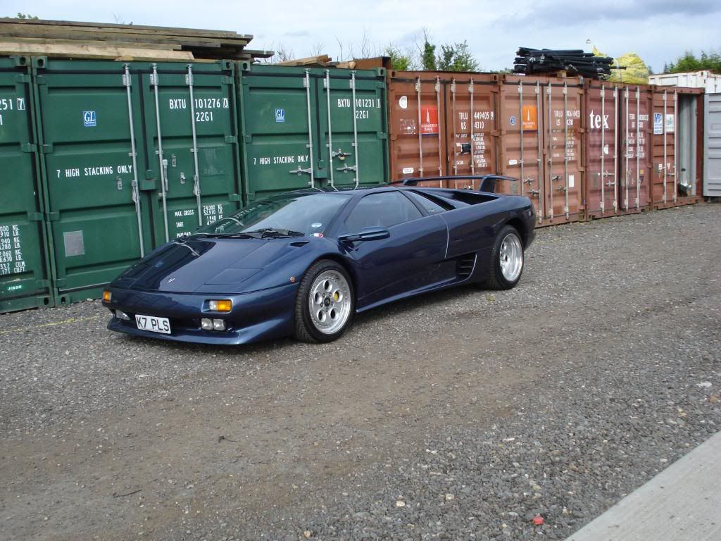

I was contacted by the owner of this car to see if i could do anything to the paintwork as the owner felt that the car was looking dull and not how it should for such an iconic supercar.
The car was booked in for a stage 2 correction detail, full interior detail and to have the calipers painted.

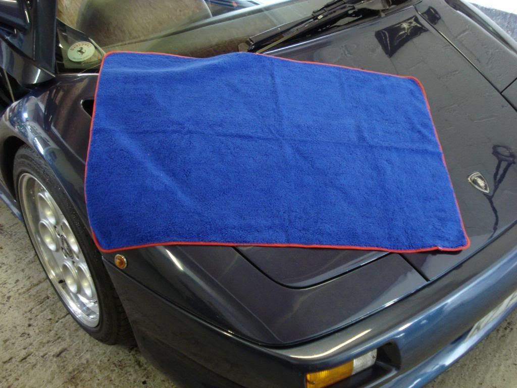

With the wash process complete i proceeded to move the car into the unit and dried it with the new Elite car care drying towel which did the job very well :thumb:

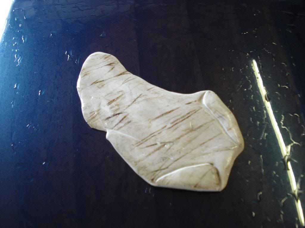

So it was time to move onto the claying and if im honest i have never come across a car more contaminated than this one :doublesho I mean running your fingers over any panel was rough like sandpaper and i don't mean that lightly.
For the contamination removal i opted for Bilt Hamber clay and used water as the lube as instructed, This left the whole car as smmoth as it should be and did it quickly it really is a nice clay :thumb:

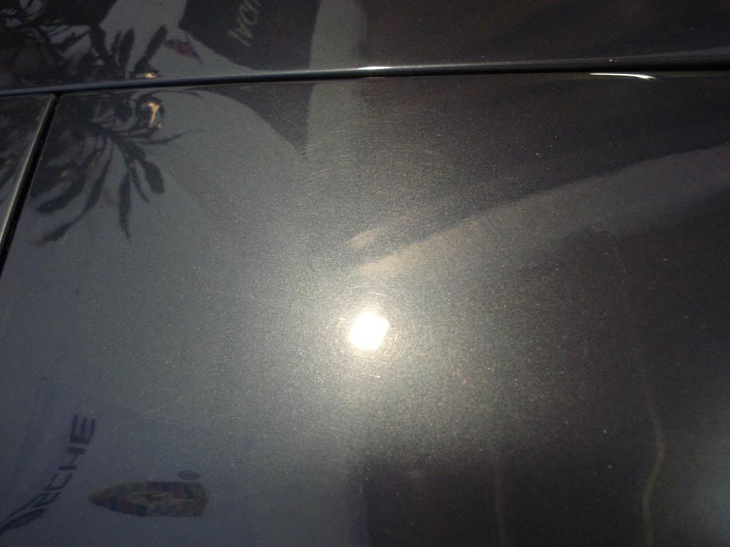

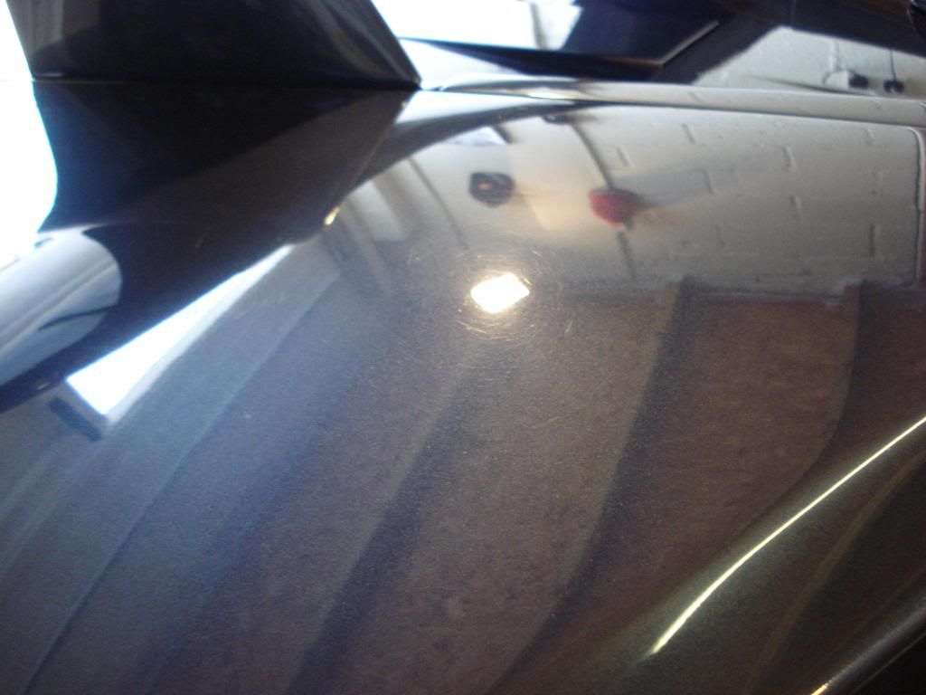

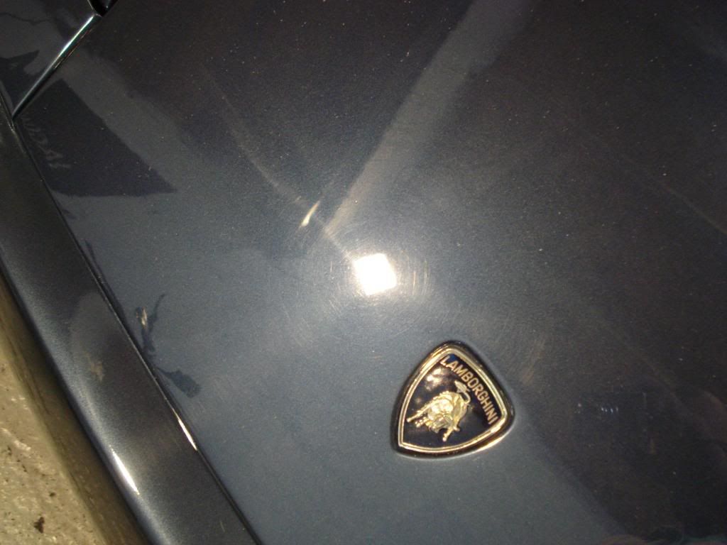

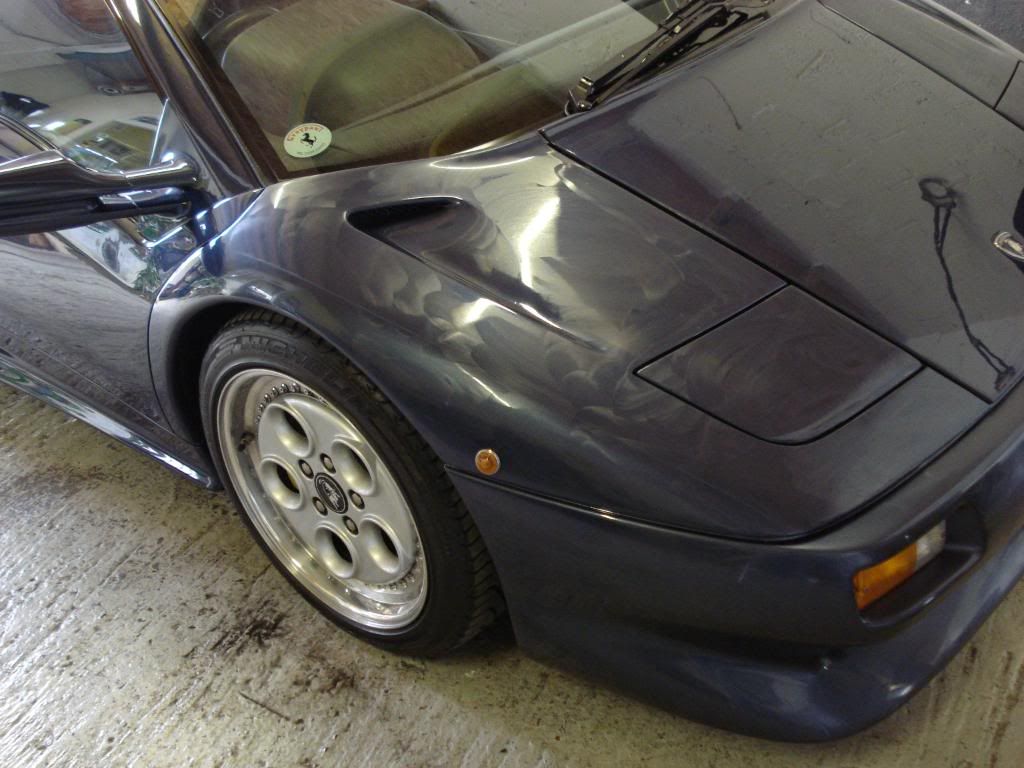

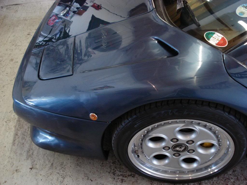

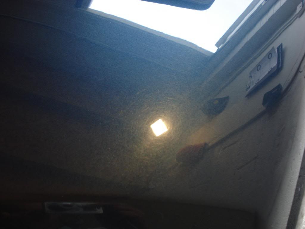

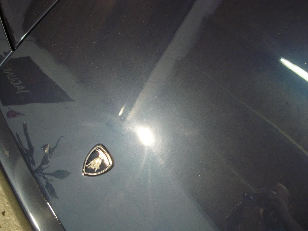

Ok now the moment of truth :doublesho I turnt on the lights to see just how bad the defects were:
Note that some areas had paint bubbling so extra caution was taken when detailing these areas.

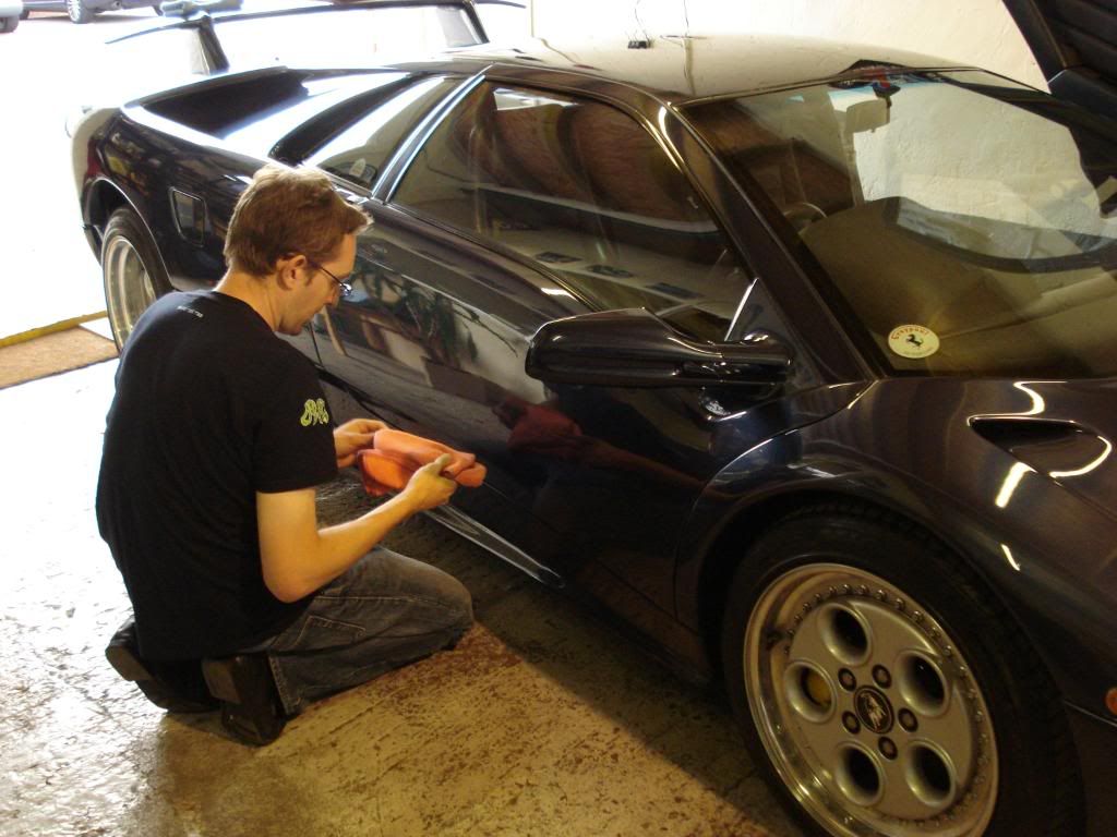

For the removal of defects after testing a few combo's i went with Menz IP followed by Menz FF which gave a lovely swirl free finish but just left a few RDS's which with some of the reading i got off the car were not going to be tried.

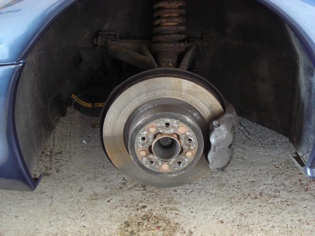

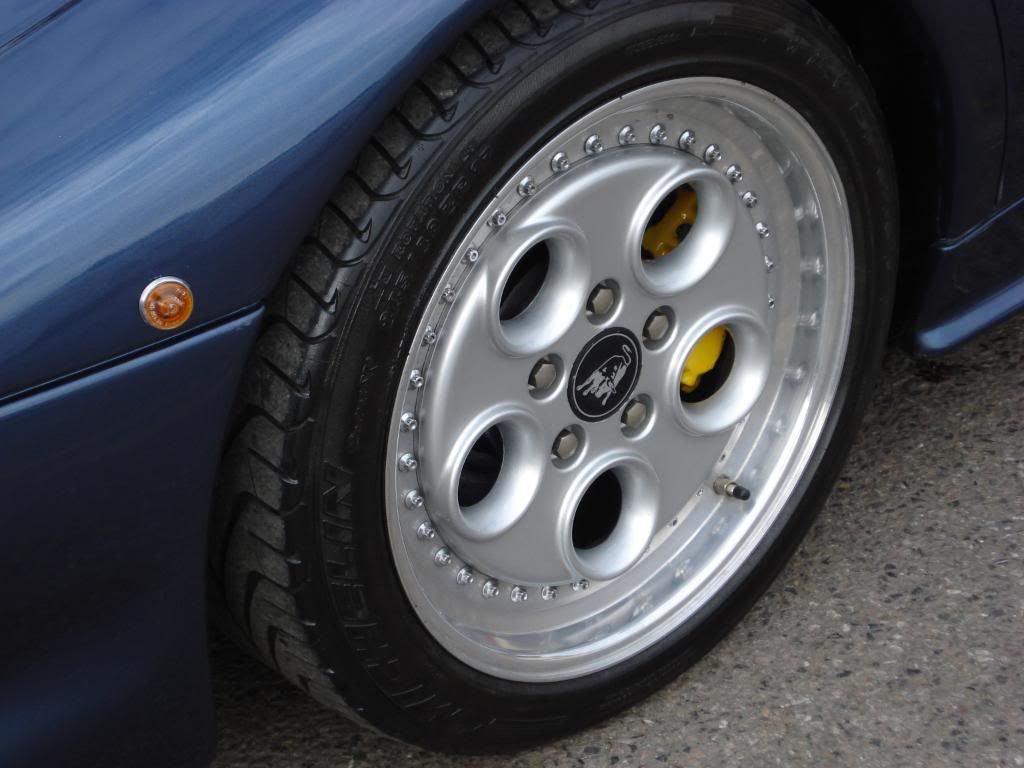

Also at this point i removed the wheels for the caliper/hub painting:

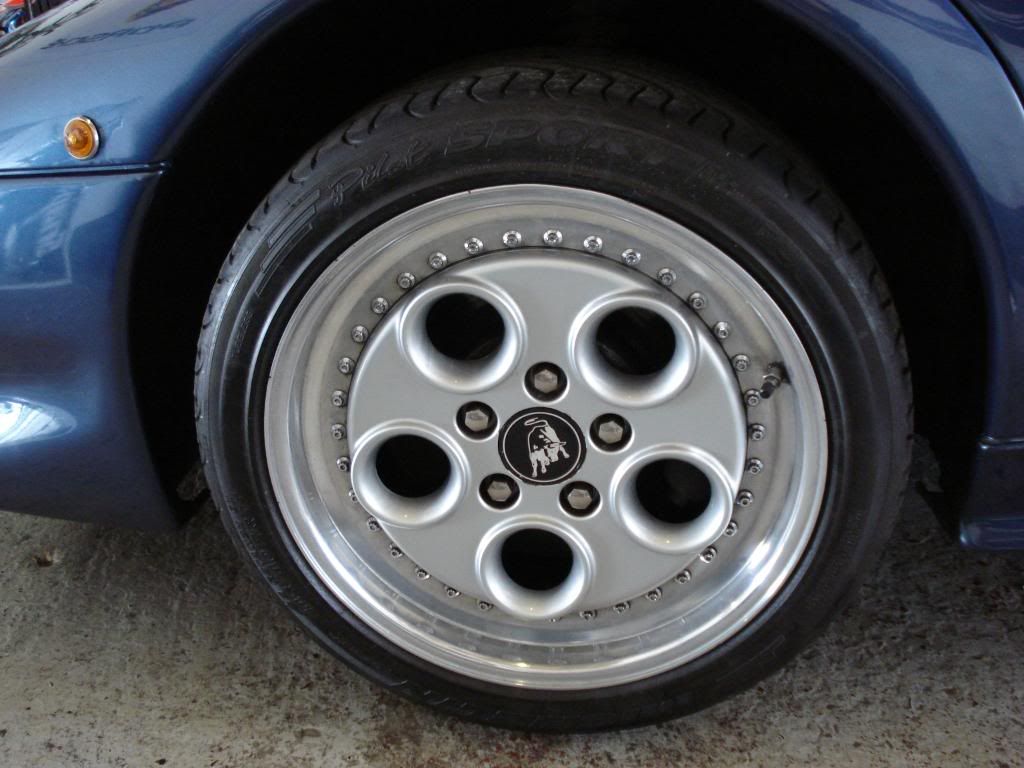

All wheels removed they were properly cleaned and sealed using Zaino CS :thumb:
Check out the width of a rear :doublesho

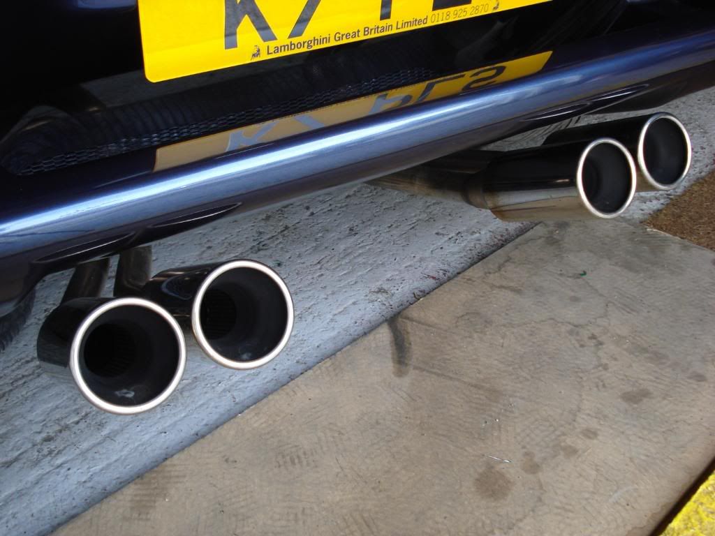

Onto the exhaust system and this was cleaned using Belgum Alu:

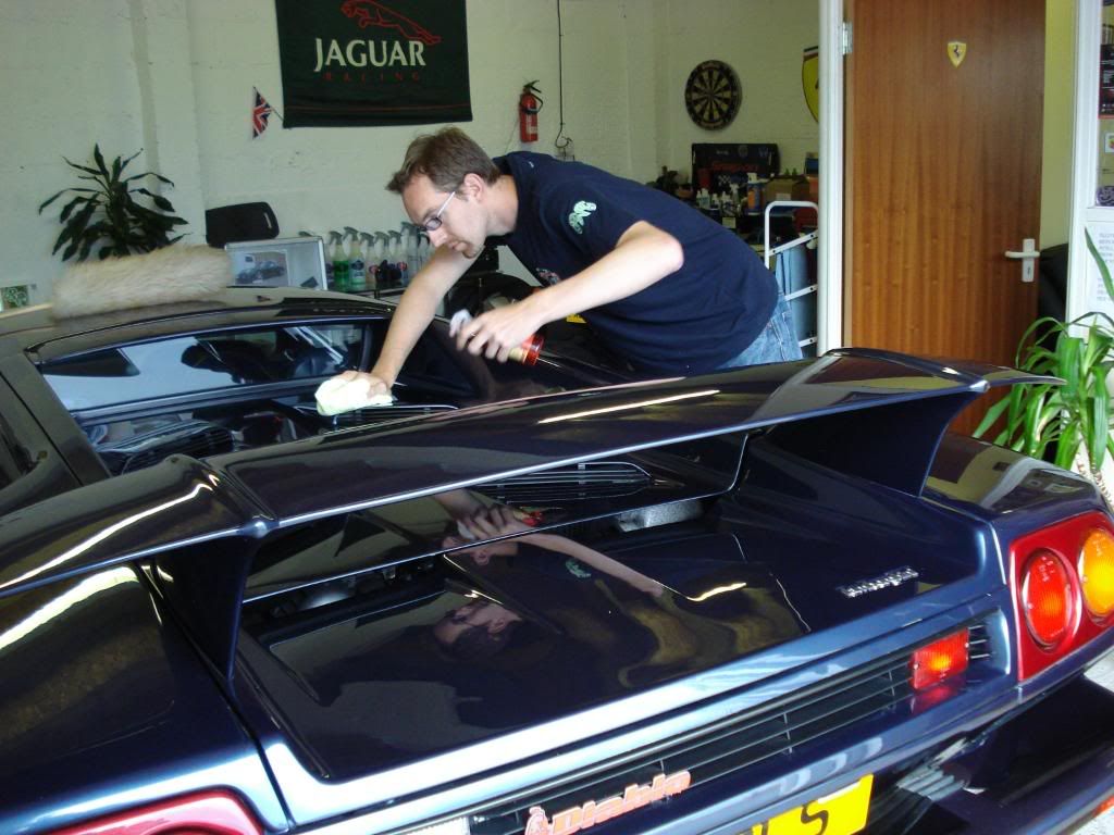

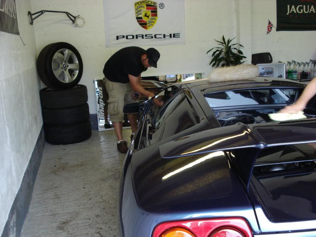

Dom and PJ popped over after hearing that there was a Diablo within a 25 mile radius of DODO towers and said they had just the ticket :thumb:
The new unreleased Purple Haze Pro :thumb:

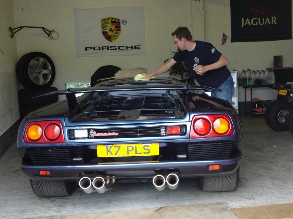

The boys in action while i supervised :thumb:

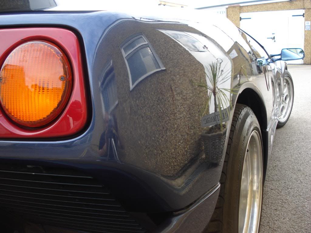

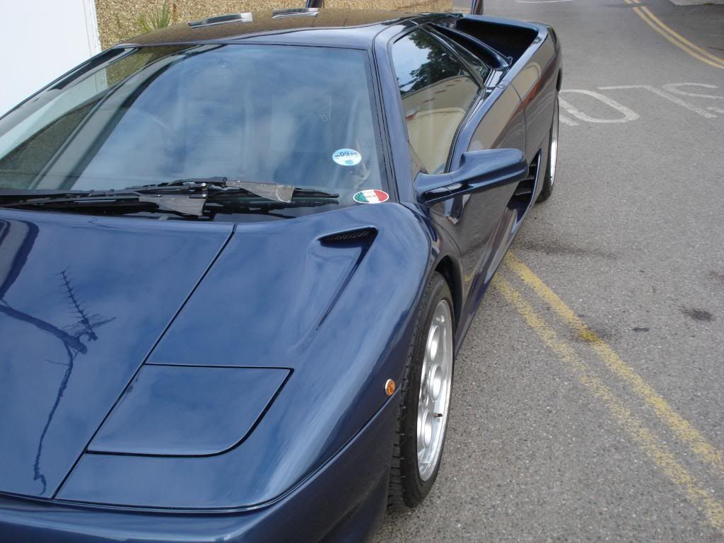

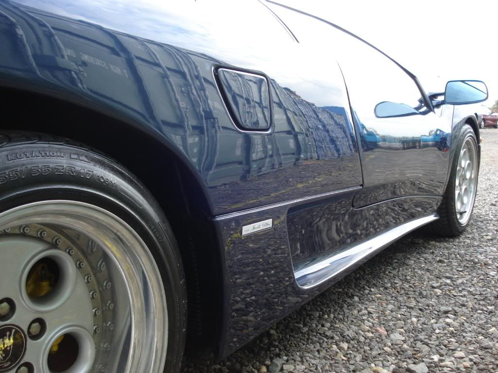

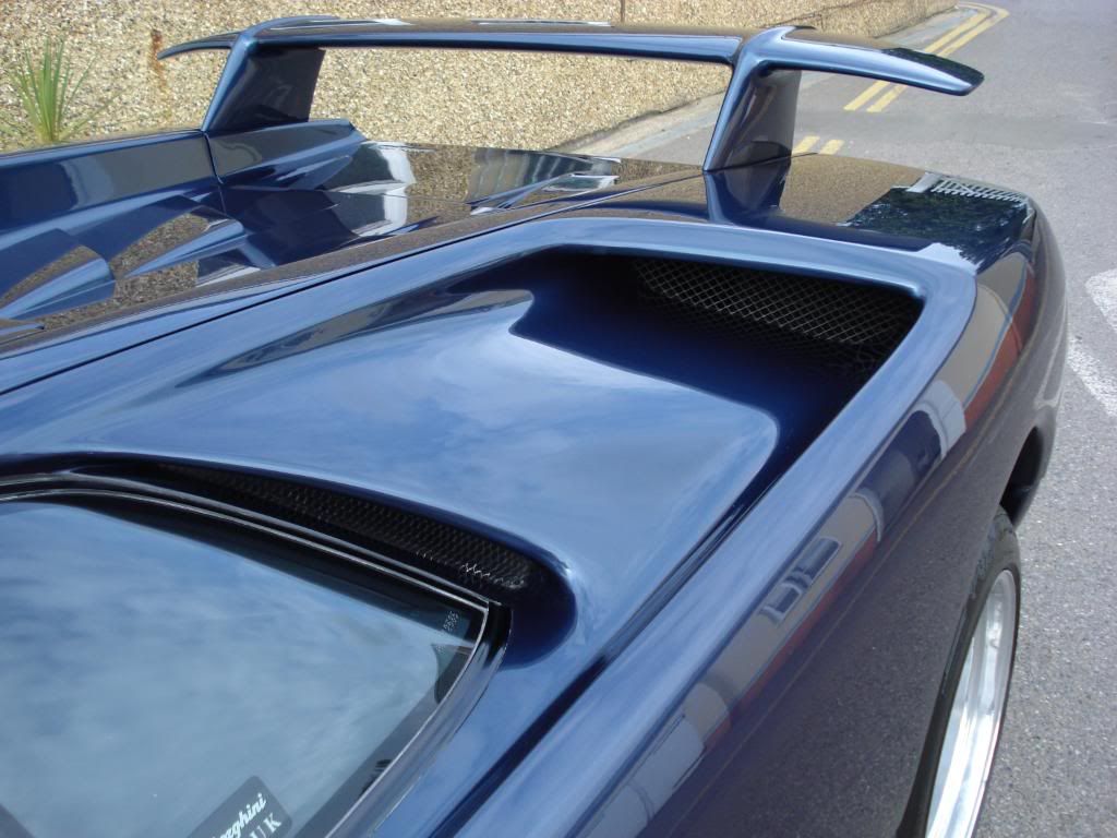

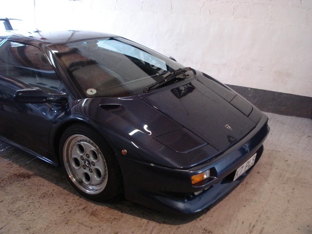

And the finished article:
