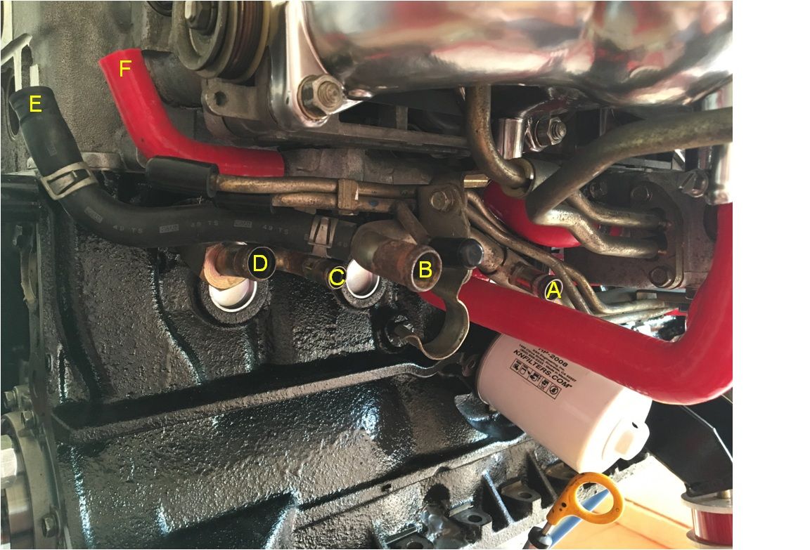

I'm in the final stages of building the engine for my 260Z and need some clarification on a couple of the hoses.
From the R33 workshop manual I've been able to ascertain the following:
A. Oil cooler water return.
B. Heater return.
C. Oil cooler supply.
D. Heater supply.
Hoses E and F are the ones that I am unsure of.
The manual doesn't show E but I'm guessing it is the water return from the rear turbo.
Thanks
63 Posts
Discussion Starter #4
I thought F was water connected to the three square ports in the middle of each pair of throttle bodies and the manual calls it the 'water bypass connector'.
I'm going to be running a single turbo and using the forward water return.
So my next question is, can I cap these lines?
63 Posts
Discussion Starter #6
Ok cheers.
I'll just cap them both then and use the front line to the water outlet.
