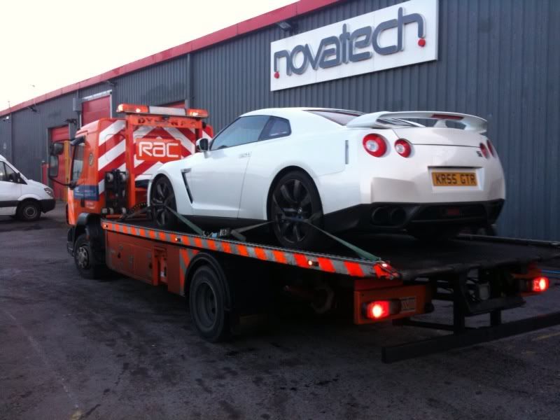

She has had to go back to Nissan to be fixed. I love my car and hate to be without it.
It has a nasty vibration from the front right which is getting worse and worse.
So they picked her up this morning and have taken her back - to rub salt in the wound they have offered me a Ford Mondeo as a courtesy car . . . yes a bloody Mundaneo.
I am fighting for a better car as I really do feel a Mondeo is just nasty.

203 Posts
It worries me to see your car strapped down without any wheel covers. Perhaps I'm just a little paranoid after several owners had damage but mine has been back to the dealer several times now and I insist on wheel protectors every time. Even the transporter guys have said how easily they have found that the wheels mark even with covers.

Discussion Starter · #8 · (Edited)
To be fair I think that is arse covering on Nissan (transport companies behalf) I have never had a wheel marked on any of my cars like that. I have seen the Ferrari van in my car park so many times dropping off my MDs new toy or after a service and there has never been an issue.
I think the reason the Nissan ones mark so easily is due to the fact that the paint is so thin and cheap on the wheels. I am going to get my wheels repainted via Nissan at it's next service - even with ten coats of wheel wax brake dust sticks to the paint and that really gets on my tits I like my wheels clean and shiney and with a wheel that has been painted and lacquered properly this is never an issue - to be honest the only thing I can actually fault with my truly awesome car is the paint on the wheels.

Sorry to hear all is not well with the beast, any idea what the vibration could be?
We do now, Darren has had it on the 4 wheel alignment and it looks like when I was in London 3 weeks ago I stayed at a certain 5 star hotel with valet parking (who scratched my front right wheel really badly) and offered to pay for the repair. It would appear that they also managed to bend a wishbone and knock the front wheels to the left with enough force that all the geo on the front of the car is out and has killed the tyres as well as a possible wheel bearing.
So luckily I have kept the email from their security manager who admits liability and I am just waiting for my darling wife (aka solicitor) to contact them with the good news.
I always stay at one hotel and they are awesome which is the Landmark - the one and only time I stay somewhere else this happens :mad:

3,574 Posts
Can´t think that if the wheel is still holding the air inside,that there is a chance the wishbone is bend...maybe the steering arm a bit,but then you should feel the car pulling hard to one side...,but never the wishbone,it is very hard:wavey:
634 Posts
Discussion Starter · #16 ·
The issue is the car would seem to have been slid into the curb and made contact on the side of the wheel. Nissan thinks the car may have been braked hard in mid corner and from the impact on the side of the wheel caused the damage.
If that makes sense.
Kp
3,574 Posts
Kp
No,that doesn´t make sence....
I can send you a picture of a GTR i bought some weeks ago ...slid onto a other car with higher speed then most of people have ever driven....it has a bend wishbone and a damage to the wheel(+ some more damage)....but be sure,you never damage the wishbone from sliding onto a curb without damaging the wheel so much that you dont feel it when driving...:chuckle:
634 Posts
Discussion Starter · #18 ·
I could feel it when I was driving - it was vibrating and getting worse and worse which is why the car was sent back to Nissan - I did not drive it over Christmas as when even I went anywhere we took my wifes X5.
