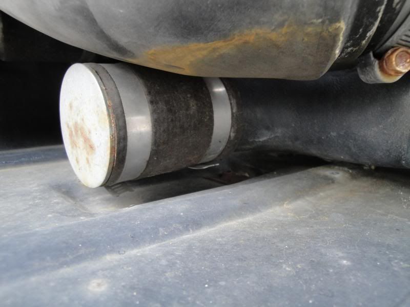

Is there any reason why this is blanked off on my R33 GTR?

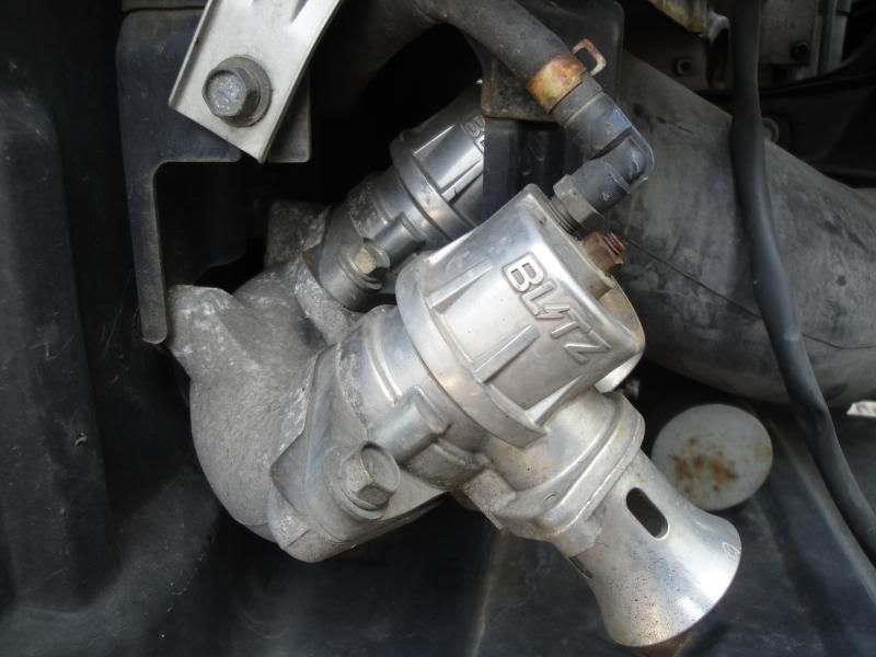

Im running twin blitz bov setup and this pipe is blanked off (see pics)
If im right, then originally that blanked pipe would attach onto the BOV location, so there would be no bov is that right?
Administrator
31,902 Posts
Yeah, it's the recirc pipe work. If you didn't have the aftermarket valves then this pipe would connect to the standard recircs
Administrator
31,902 Posts
Yes but there's no need to afaik and it's difficult to replace if you ever wanted to go back to standards.
