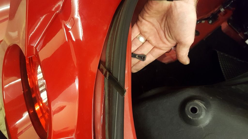

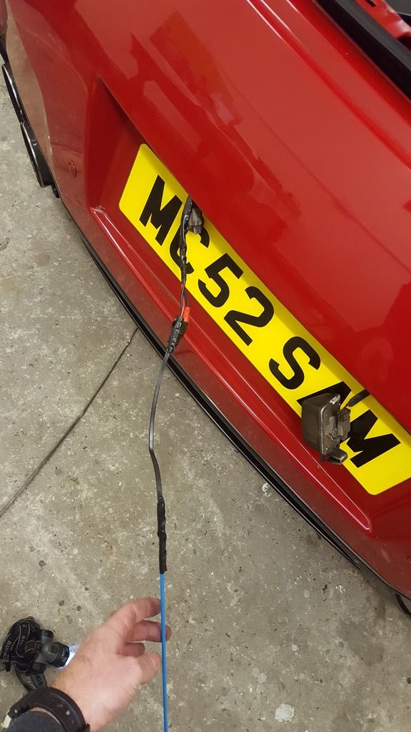

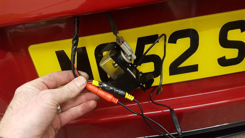

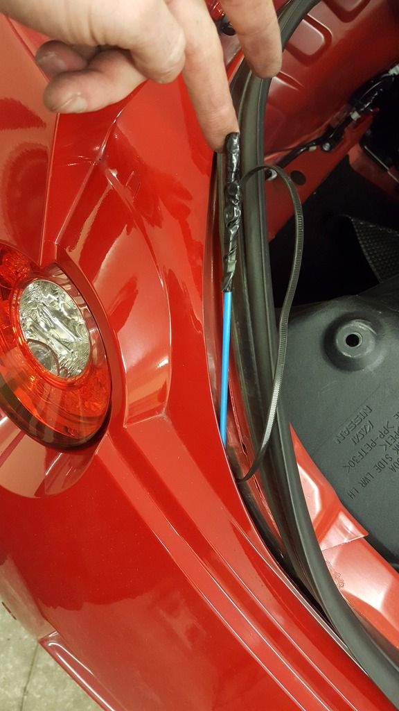

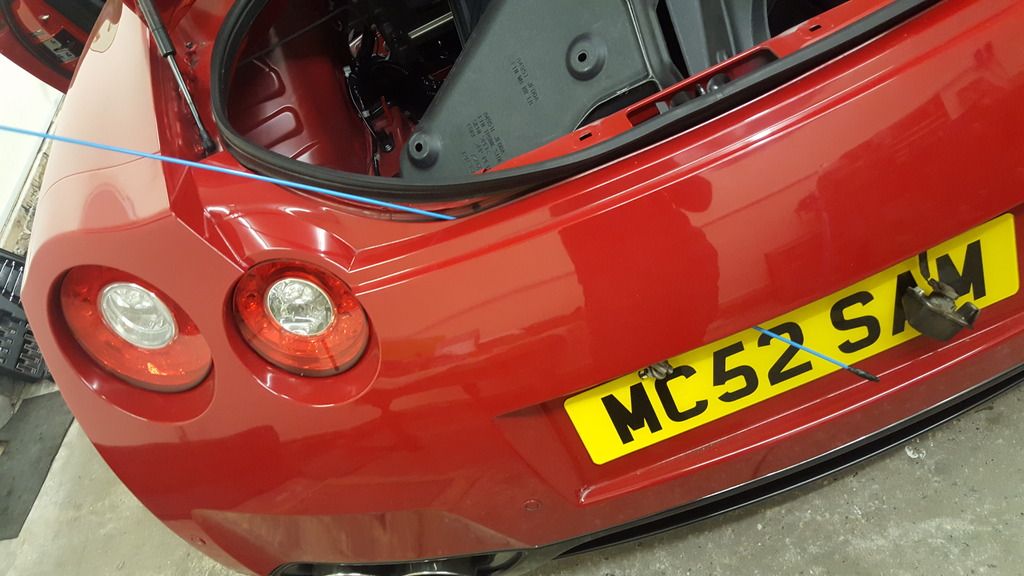

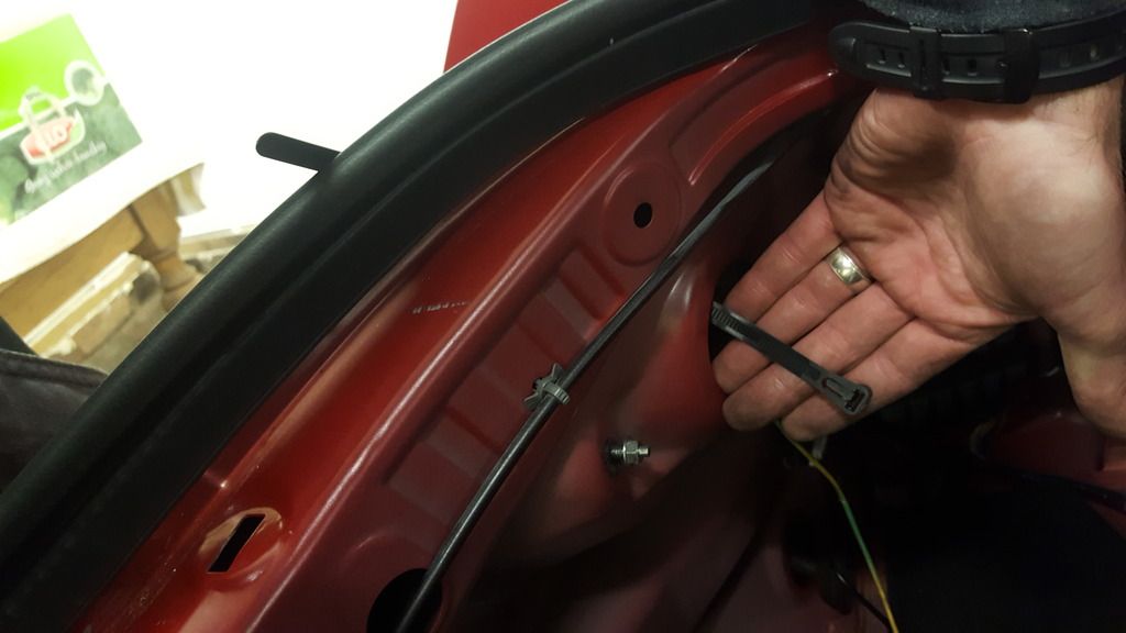

I done this myself a few months ago. It is a bit fiddly and as you say you can't actually see where you've got to go.
It was my intention to do a 'how to' so I took lots of pics, but haven't got round to writing one yet.
For the part your talking about I found it it best to do it in two stages-
First I used a large cable tie and went from the gromet in the boot to the top of the bumper (see below)
Then I used a rod behind the bumper to the number plate light-hole (see below)
Join the two together
And pull through
Hope that helps.
